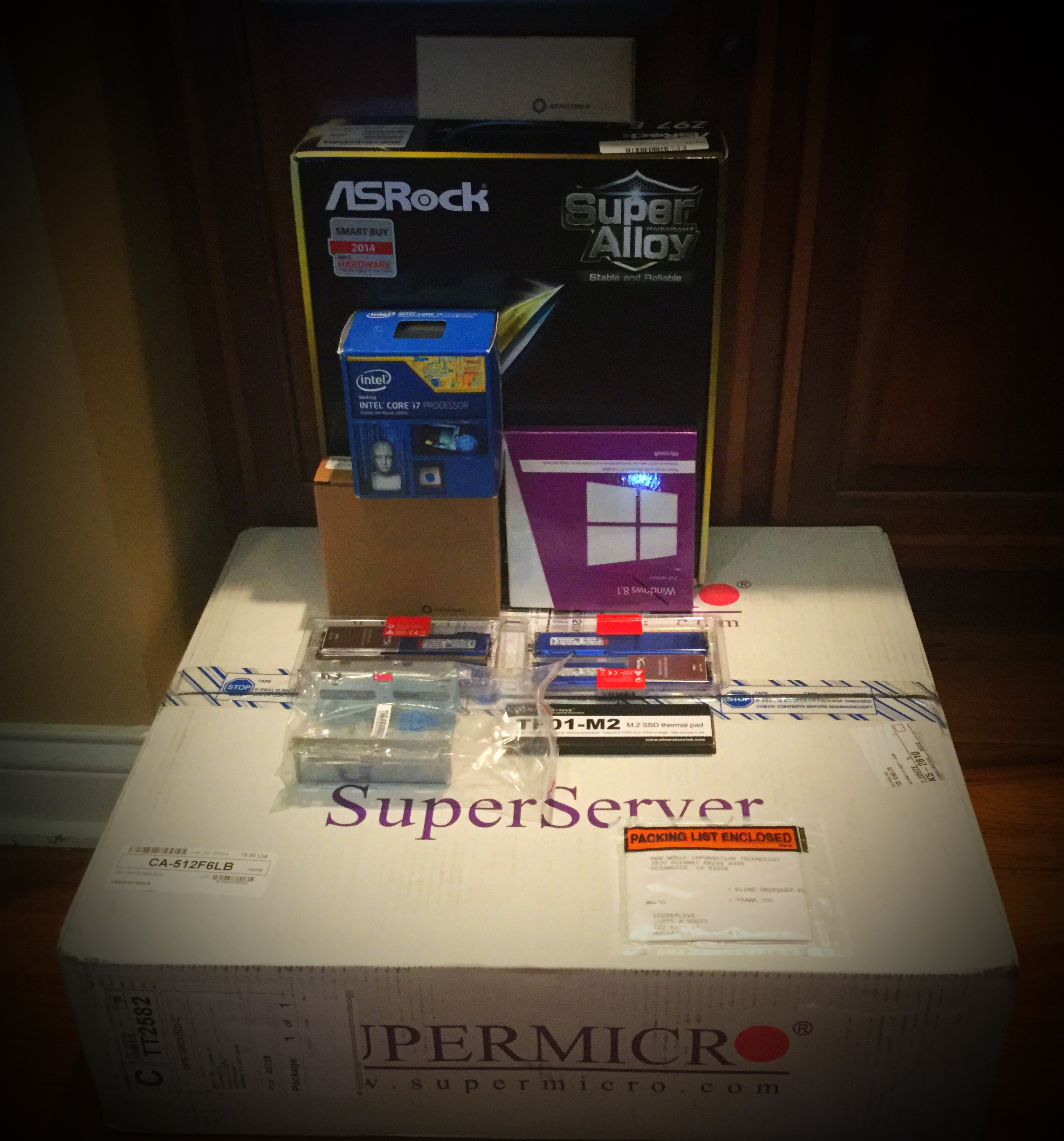

Re: Intel 4790k 1150 CPU
My recent 1U
Supermicro CSE-512f-600
i7 4790k
32GBs DDR3 1600 CL9
Samsung 950 Pro NVMe M.2
Samsung 850 Pro x 2 @ 1TB
Dynatron water AIO
ASRock Z97m WS
This DAWg will hunt.
Total U$D outlay ? (Discounted and RRP) ?
OMG this is a heavy pc machinery! This is like Christmas, Eastern and Birthday at one time! :D :D :D beautiful!
1075 total...
Bought the same in 2016 for 1800...
