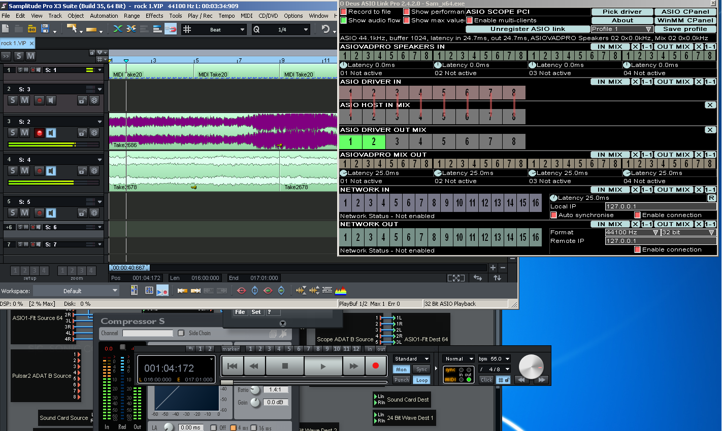

asiofixer
Re: asio multiclient
Post by asiofixer »
Hello folks!
for people who doubt about scope working with asio deus here's a picture
i'am using scope 5.0 32 bit driver on winx64 with samplitude
think that scope 5.1 and scope 7 32 bit will also work! with asio dues
asio deus fix my old scope 5.0/win7x64 latency problem!
now samplitude can record on asio 2 direct monitoring 1024 samples buffer without latency!
even samplitude vst work without latency! (in play mode)
thanks
