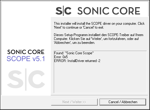

I've get the same problem.
now the scope working only in "test mode" and when I try to reinstall the driver again, i've get the error in the attached picture.
i want to disable the test mode in windows, somebody know what should i do?
Ripper
Posts: 230
Re: no drivers under Windows 10Pro Build 14393release 160715
Post by Ripper »
Everytime you run the installer you will have to be in test mode.

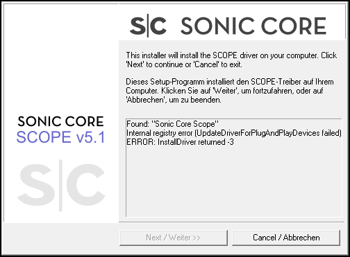

After driver uninstall i get deferent error:

Post by BoBiS »
Fix it!, i've download new copy of the drivers and it's work great.
