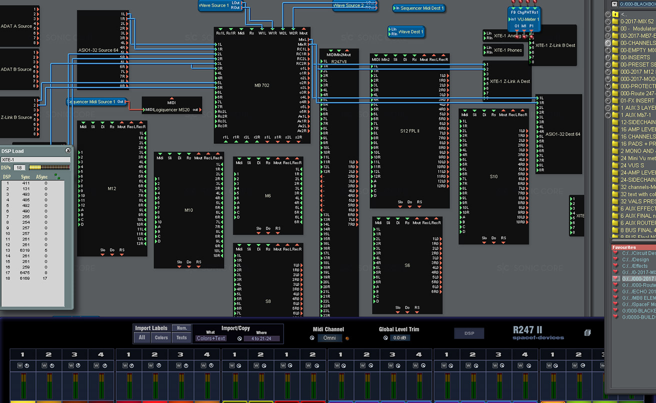

Hi there,
That's my default project modular mixer setup under xite-1 / win 7 pro 64 bits, for quite a while now, a few years I think.
I am using it without a problem with studio one v3, and various external sources (synths, mic, guitar , bass etc).
I have several gates, Vincos, Eqs etc in the channels in the default project. I can add modulators, synths etc if needed, but i confess i under-use the xite in favour of vstis and hardware synths these days, eventhough I would not change it (xite/mod mixer) for anything else for direct inputs of synths, guitars, mics etc. it works perfect for live too (i am just rehearsing stuff for fun, hoping that i will be able to bring my whole setup on a scene in a few month, which is just a matter of working a few tracks, and finding a couple of other musicians (and a big car or a truck because my setup begins to be heavy and big ;-)
(pic is 80% of real size).

Re: SpaceF Modular Mixer in 2016 (anyone using it with XITE1
Cool the way DSP 18 gets maxed out.
I find that leaves room for everything else after the last 4 are packed.
spacef
Posts: 3364
Post by spacef »
dawman wrote:Cool the way DSP 18 gets maxed out.
Yes, dsp 18 is fully used, then the dsp 17 is less than 15%, and the few first ones are around 30 / 40%.
I can still load many stuff.
Also, I don't use DSP allocation, I let Scope do its thing by itself, it works just fine that way.
