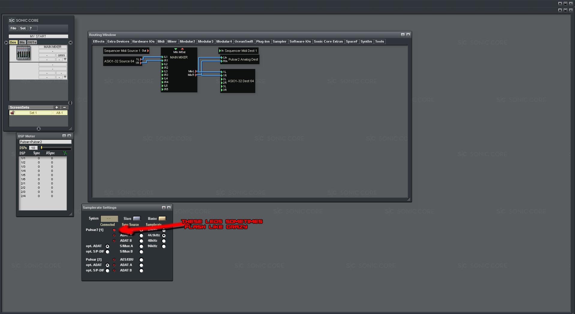

I have been getting problems running scope with several PCI cards.
Wen-ever i have 2 or more cards connected I get the screen like in screenshot1, or i get an error to check the STM connection, I have gone thru BIOS settings, windows settings, power settings, device manager...
I cant figure this out... This is happening on a brand new build with a few months old, so really doubt its any faulty hardware issues like MOBO etc..
Its extremely annoying because it seems to happen half the times I want to load Scope, sometimes unplugging the PCI cards and connecting them again works, but I simply refuse to do this every time I wanna start scope.there have to be other ways to get this working a bit better!

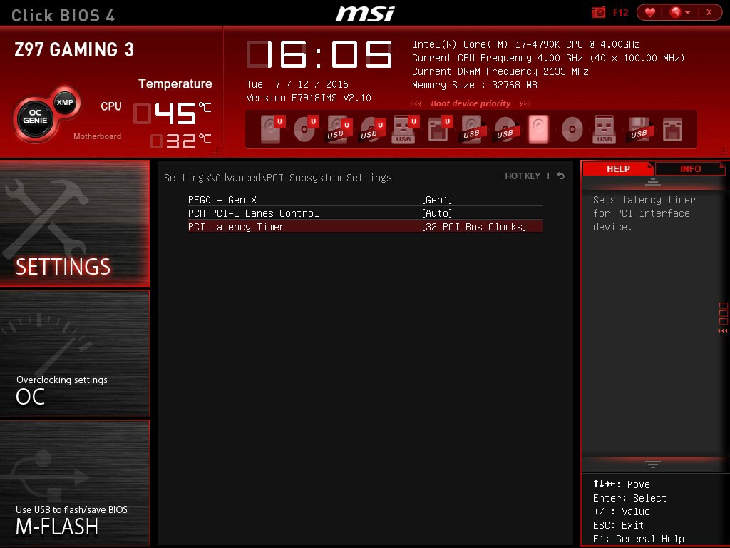

donno how the "PCI subsettings" at the BIOS relates to the issues, but i took a screenshot anyway, I don't understand what are those settings about so leaving them as Default

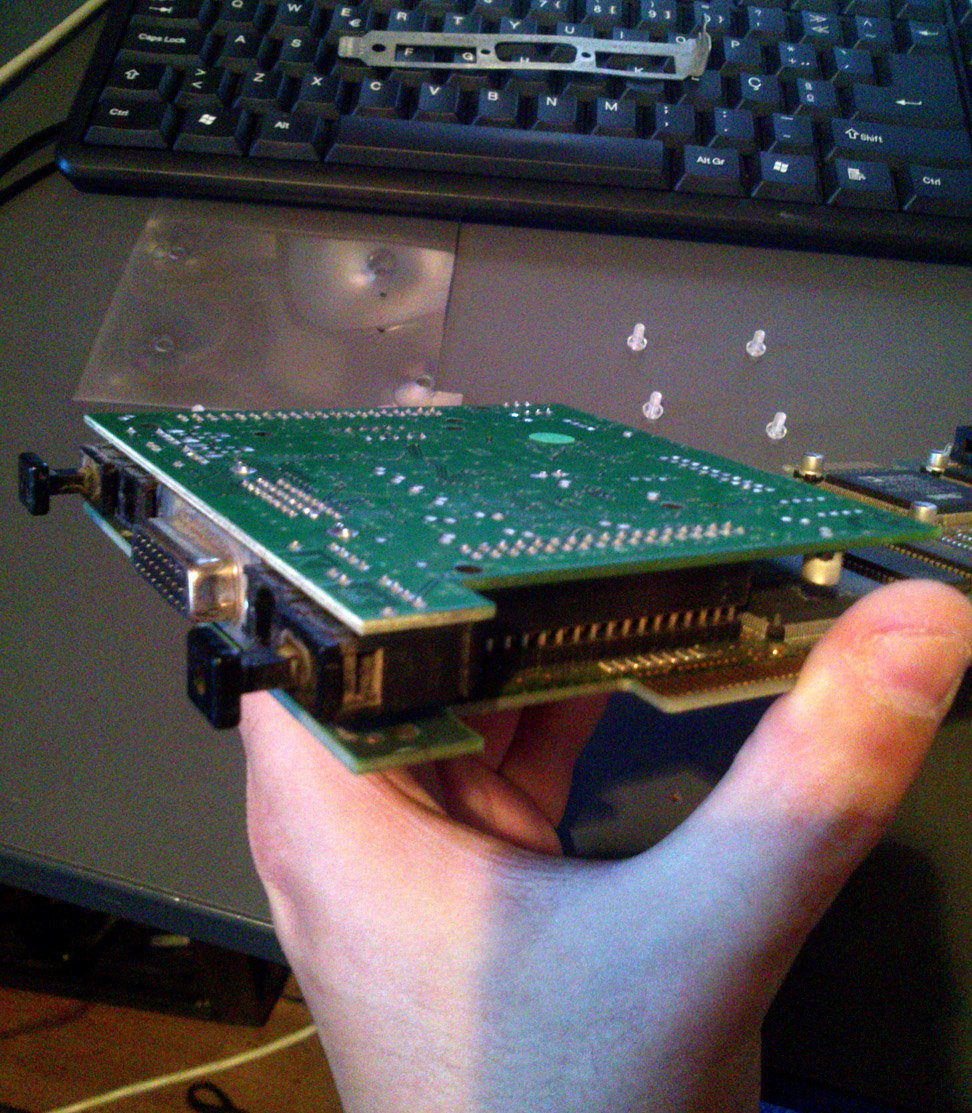

took off all the screws, 8 silicon screws in total ,4ontop 4bellow. Plus took off the 2 screws from the I/O, cant really reseat anything
, id even say the silicon screws arent doing much this is all sealed up or soldered

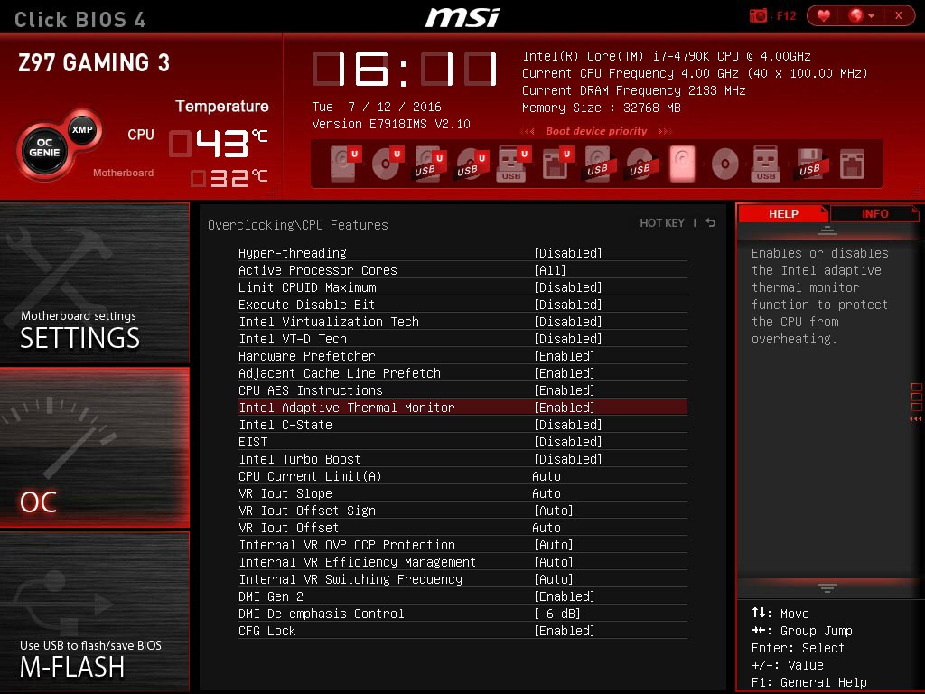

I noticed a few things in your BIOS. I have my PCI latency timer set to 96. You should try that. 32 is too fast from my experience, but don't go too far down, 128 is too slow. Also turn off both hardware prefetch and cache line prefetch.
