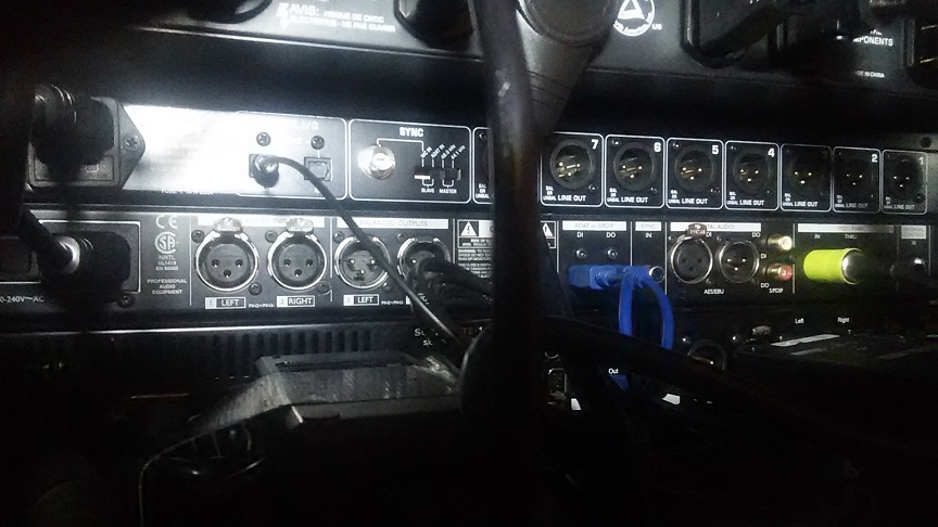

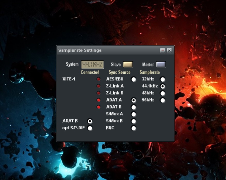

Found the problem....
Using ADAT Out only and set at 44.1k Master on ADA8200 means there's no clock as it isn't needed.
Just sending out info 8 x analog ins on a modded ADA from Black Lion Audio.
TC Fireworz has ADAT A In and out.
Crackling until I set the Sample Rate Window from Master to Slave.
Don't care who is the boss in the set up as long as that rice crisp shit stops.
Now I have XITE-1 Mic Pres working Analog I/O working AES/EBU working and both ADATs working...
AWESOME.....
AWESOME.....

Re: xite 1 + asp 880 adat clicks and pops
Never understood clock very well.
Always assumed all ADAT I/Os had to be connected.
Behringer is weird as it must be set to Master but have no ADAT in connected?
TC Fireworx has no Master/Slave setting it just works out that it is Master once
Scope becomes the Slave.
Im just glad that crackly stuff is gone.
This whole Master/Slave thang is offensive and racist.
No wonder they invented MADI.....
