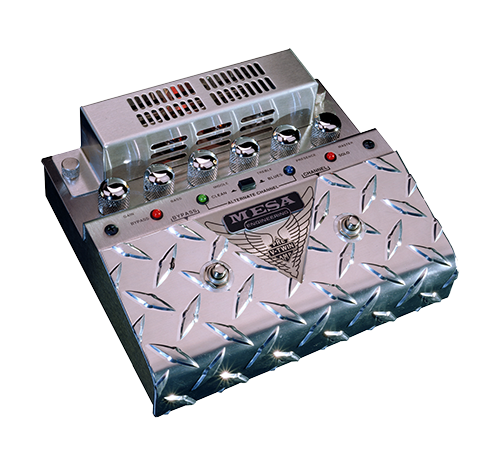

My biggest regret from gear buying days was not picking up one of these little beauties - it enjoyed a 12 year production run from 1994 to 2006:
Mesa Twin Valve Pedal
