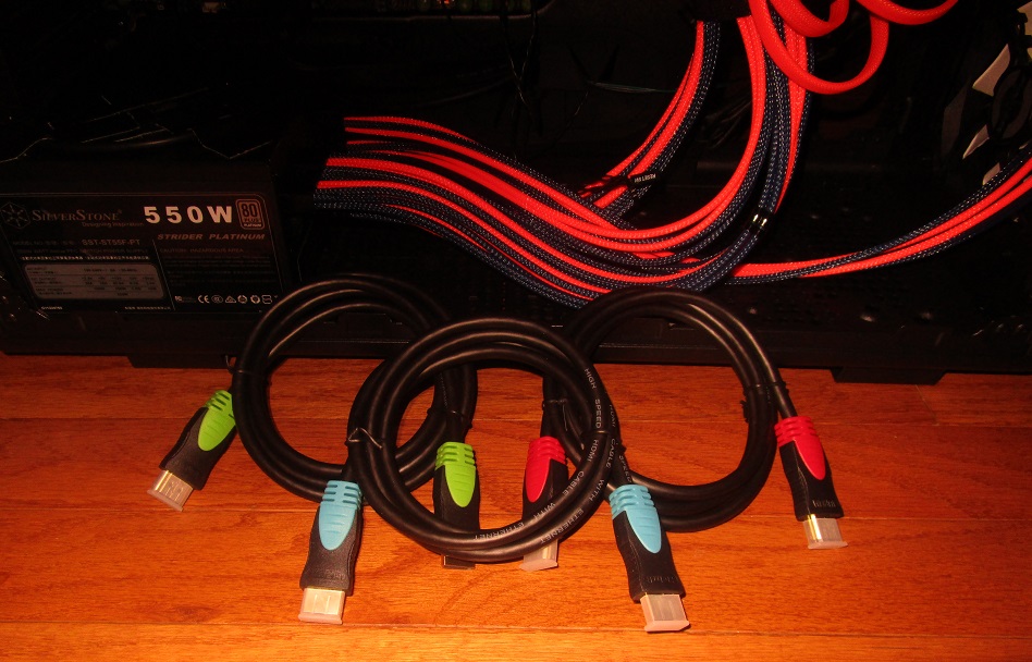

My new HDMI cables came in today (I bought a couple different brands just in case). Everything is working. Time will tell. Keeping my fingers crossed lol
