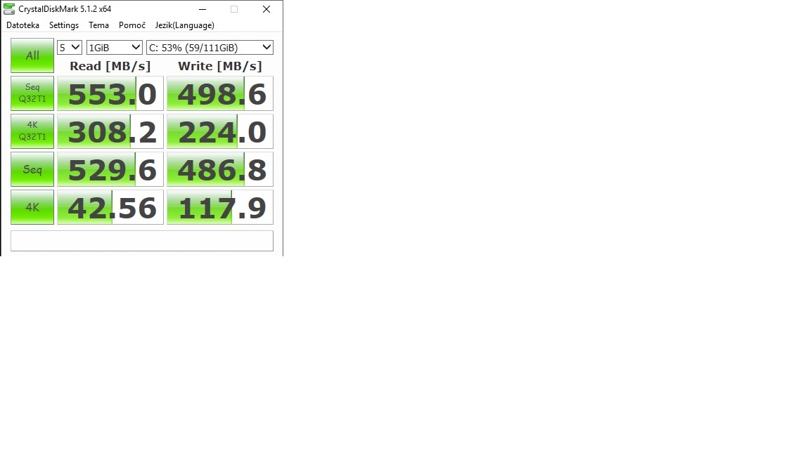

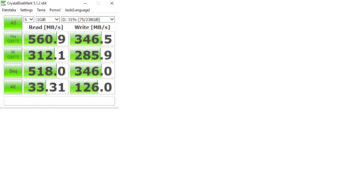

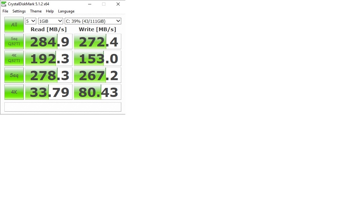

Thanks for answers and opinions jksuperstar and dawman.
I have tested my ssd's with crystal software.
I have 3 ssd's.
One Samsung 840 evo 128gb is located in this computer, sata II and
other two Samsung 840 evo 128gb and Crucial MX100 256gb in my main music computer , sata III.
I have attached both 3 test results.
I have 3 ssd's.
pictures :
Sata II - samsung 840 evo
Sata III - samsung 840 evo
Sata III - crucial MX100
