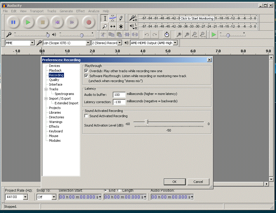

I use Audicity to route sound from Xite LINE-1 to my HDMI sound interface....
