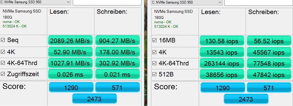

as ssd.jpg (129.48 KiB) Viewed 1026 times
