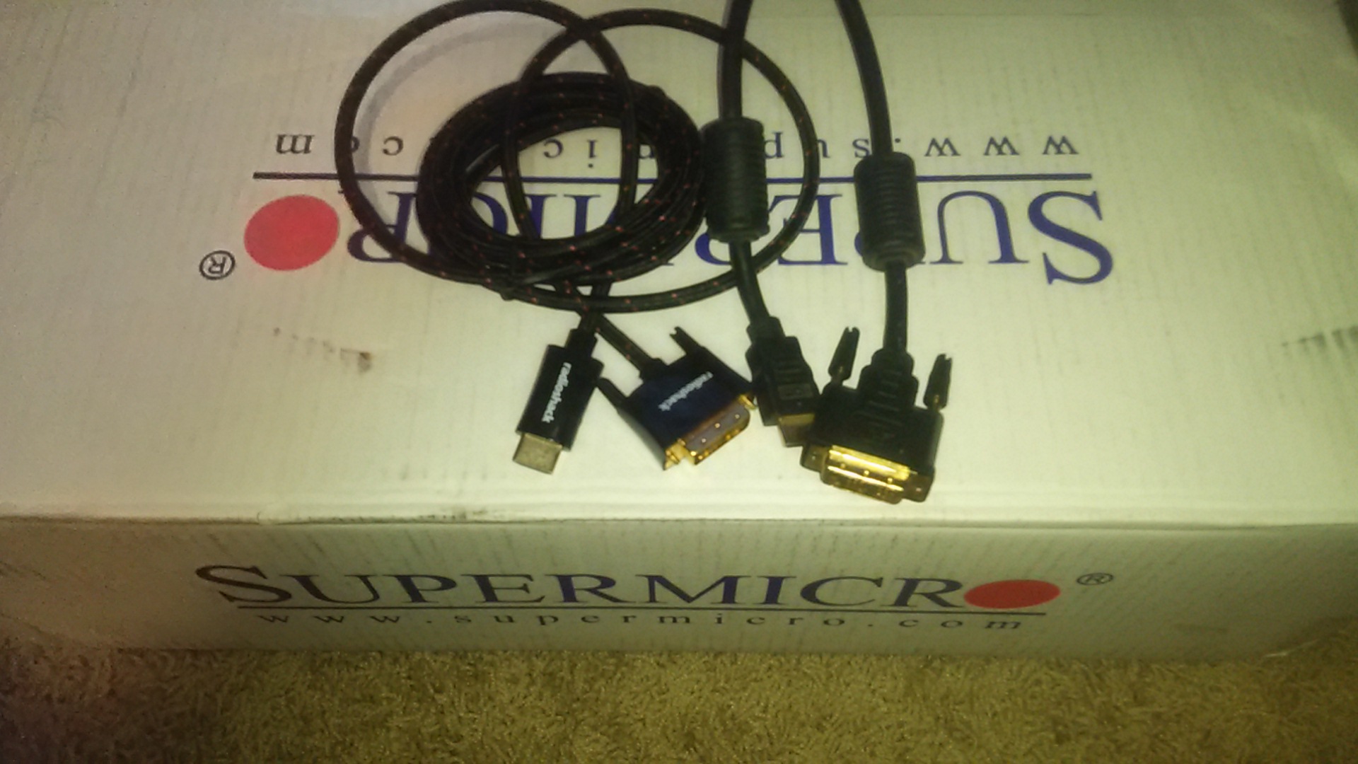

New PCI-e 1X with new style cable is working out great so far.
Below are the old style HDMI.
New card is slightly different and cable is using
2 x small ends instead of 1 with the bigger connector.

if reseating everything doesn't help, try a new HDMI cable. get a good one, not a bargain cable. many HDMI cables seem to be pretty poor quality in general.
Re: XITE Error
The Gold one you sent me with the PCI-e 1X card is shorter and obviously higher quality than my favorite Chinese brand from Radio Shack.
