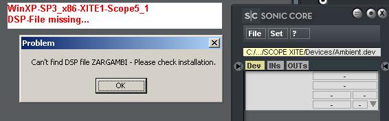

anyone help, please?
WinXP-SP3_x86-XITE1-Scope5_1
DSP-File missing:
- Ambient SC
ZARGAMBI
- DarkStar_sc
ZARGDSTAR
- OrionCustom_sc
ZARGORCU
- Quantum Wave v1_1.dev
ZARGMACA
- Red Dwarf EX v3_0_2.dev
ZARGREDW
WinXP-SP3_x86-PCI-Scope5_1
no problem
no missing file
but can´t found the files in Folder DSP
I checked the archives (13.01.2015)
ftp://sonic-core.net/software/3rd_Party/Zarg/
but can´t found the files :cry:
EDIT: 07.12.2015
solution check also:
http://forums.scopeusers.com/viewtopic.php?f=1&t=34062
parameter change is cracking sound !
"...uppercase and lowercase characters of dsp-files..."

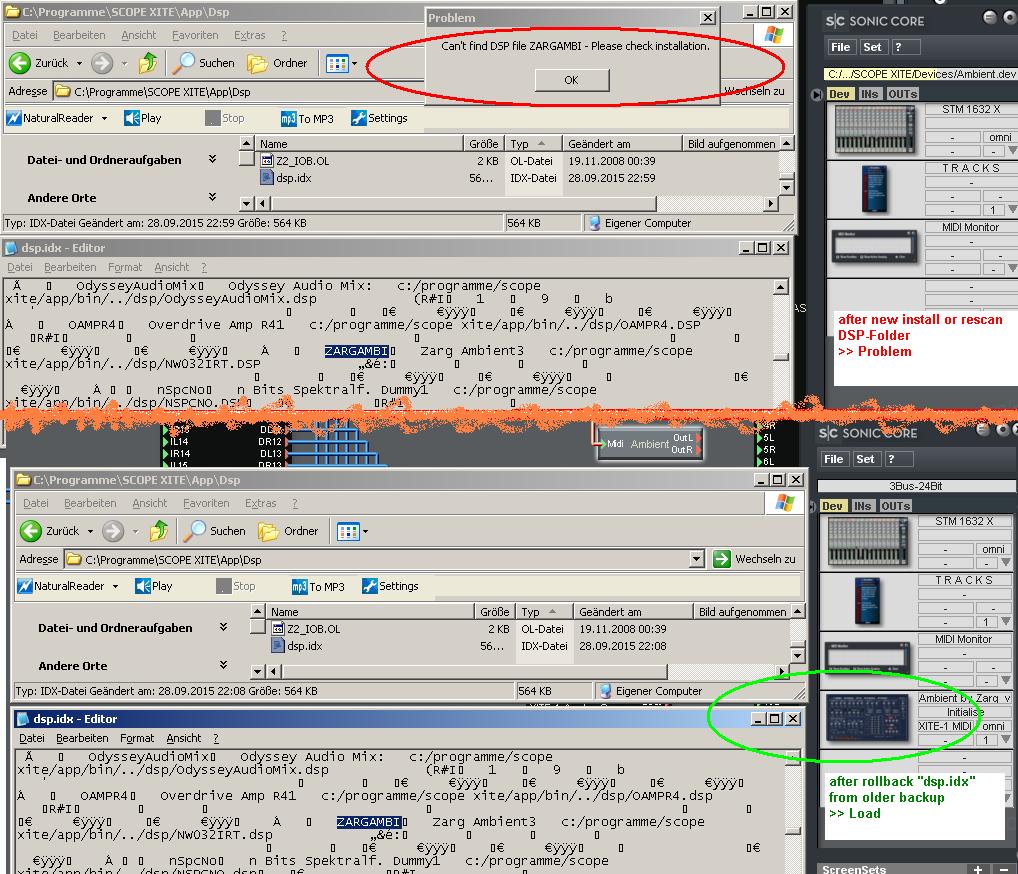

Spielraum
Posts: 806
Location: Raumschiff Erde
Re: JOHN BOWEN Special_Collection-DSP_missing
Post by Spielraum »
spot the difference...
after rollback "DSP.IDX" from older backup
>> all dev load now perfect
however, i find no difference :roll:
JOHN BOWEN Special_Collection-DSP_DeBug.JPG (210.66 KiB) Viewed 1772 times
