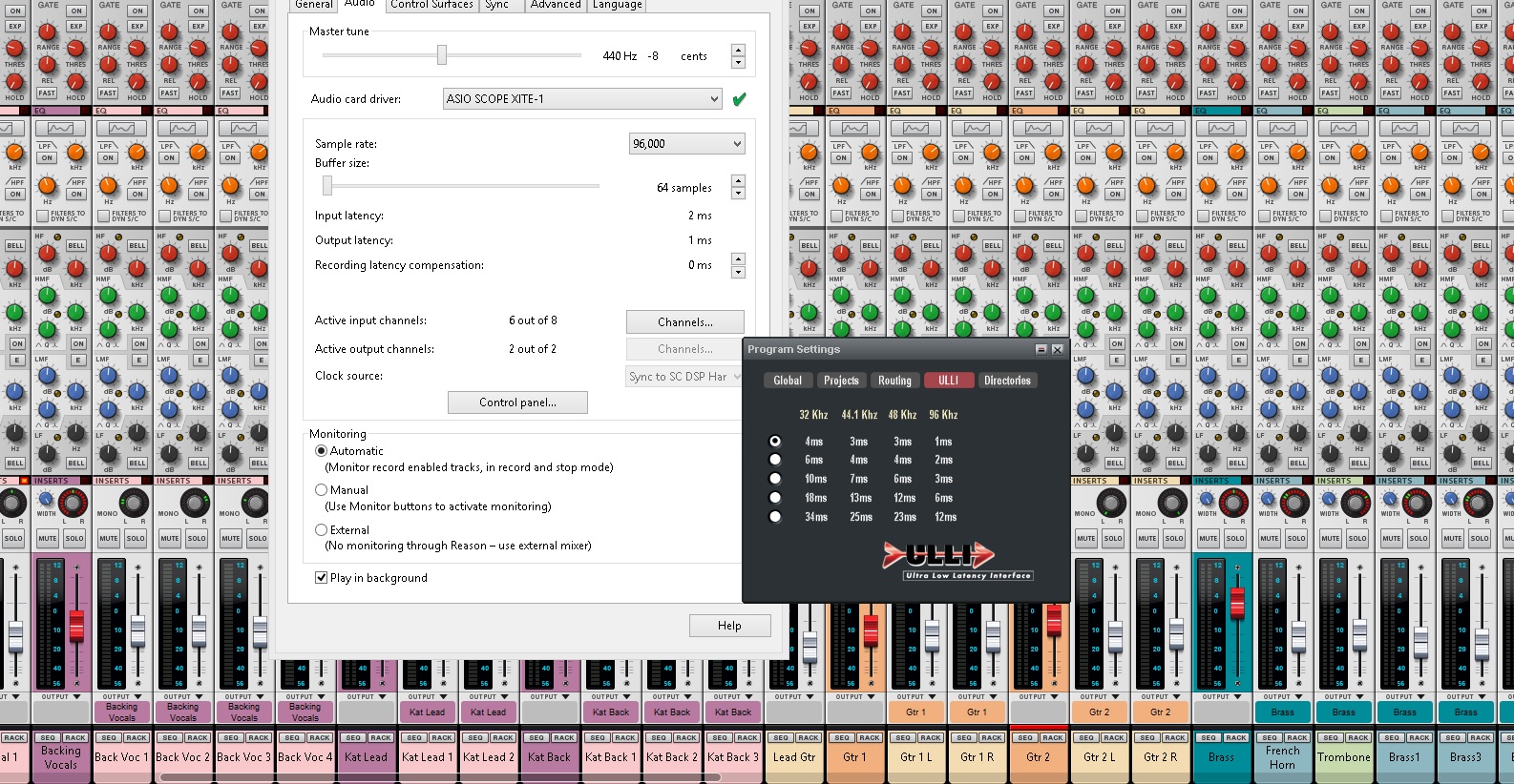

Having read the discussion about Protools + Scope latency here :
http://forums.planetz.com/viewtopic.php?f=5&t=33821
I decided to do my own test. I am using Reason to mix, and Scope (XITE-1D) to Master, therefore using only 2 ASIO channels, with a single round trip (when recording Scope mastered signal back to Reason) or half a trip when just recording / mixing a track (pre mastering stage). System is an i7 4790 @ approx 3GHz & 16GB Ram.
From these test results, mixing 65 channels at 1ms @96KHz, there is very little noticable effect. I may have to start playback later than usual after a song load whilst reason loads its samplers, but after that its fine doing a complete mixdown with no dropouts.
I note I never would have achieved this kind of result using Rewire and Cubase - rewiring multiple channels and then multiple ASIO to Scope. Anything less than 23MHZ (at 48Khz) would have created dropoiuts on the same system even with AsioGuard.
So to me brings into question the latency overheads of using multiple audio pipes (ASIO / Rewire) as opposed to - a single round trip on just a single stereo pair !

My91 glad you found a way to improve your rig ! That's what it's all about.
Recording is also latency free 4 me at 2ms - as you can see on pic I have extra inputs from XITE to reason to record love guitars, vocals and ProWave.
Input mic signal can be mixed straight to XITE output as well as Reason so latency free monitoring

Re: Scope + Reason @96Khz + 1MS
Crystal core boasts 230 channels @48 KHz on one card at a cost of approx 5k. That's just the processing power with no DAW. Looks to be my combo of XITE-1D plus Host is of similar cost but includes DAW running so far 80 channel mix @ 96 kHz.
I'm running up to 5 plugins on individual tracks, with some subgroups, and negligible latency.
Maybe a bit like comparing apples to oranges technologically, but still happy in terms of outcome !
