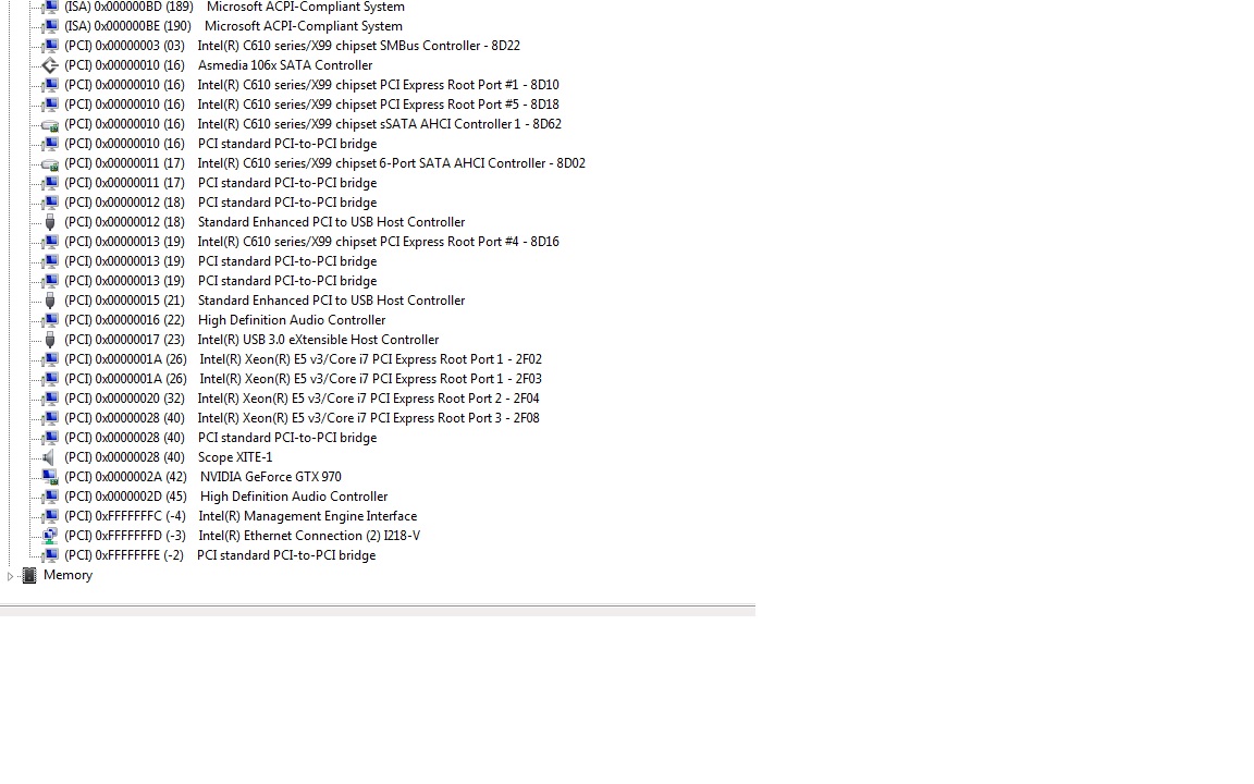

Here's a screengrab of my IRQs:
I'm not sure what BIOS changes you mean. Is there a list somewhere? I haven't made any changes so far.

Re: Anyone successfully using Cubase Pro 8 with Scope on XIT
pci to usb host controller on the same irq as the XITE? that's probably got something to do with the bad behavior...
garyb wrote:pci to usb host controller on the same irq as the XITE? that's probably got something to do with the bad behavior...
Is there a way to tell which slot corresponds to which IRQ in that list, or do I just have to try trial and error?

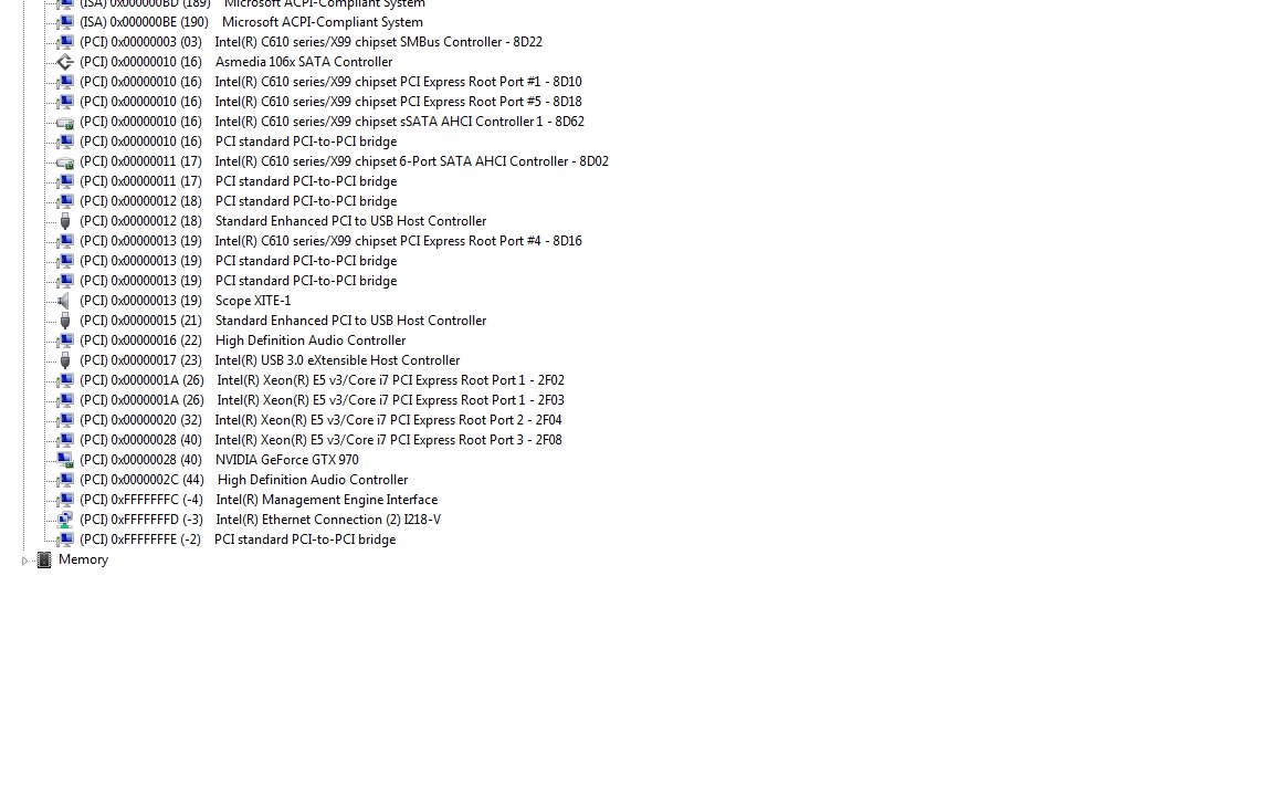

OK, I tried every free slot (I can't get to slot 1 due to the Graphics card. Also took note of the IRQs each time. So the question is, which slot looks the best bet and what do I have to disable (and how - in BIOS?):
Slot 2:
IRQ Slot 2.jpg (196.1 KiB) Viewed 6892 times

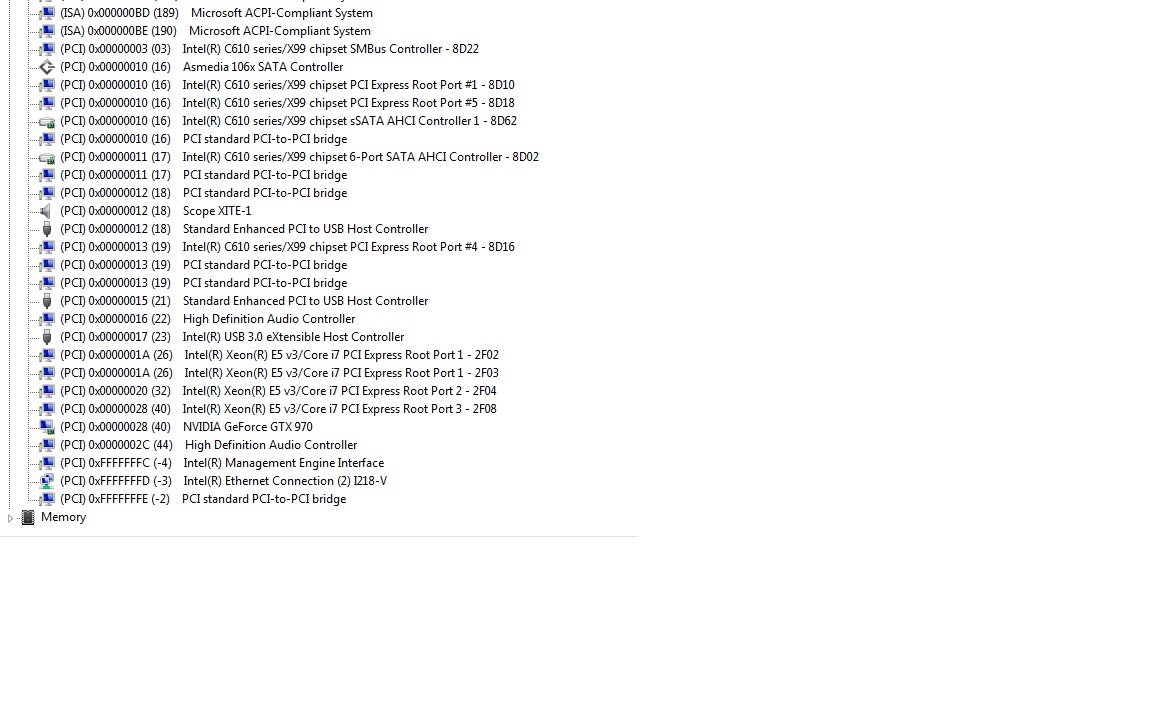

Slot 3:
IRQ Slot 3.jpg (191.97 KiB) Viewed 6892 times

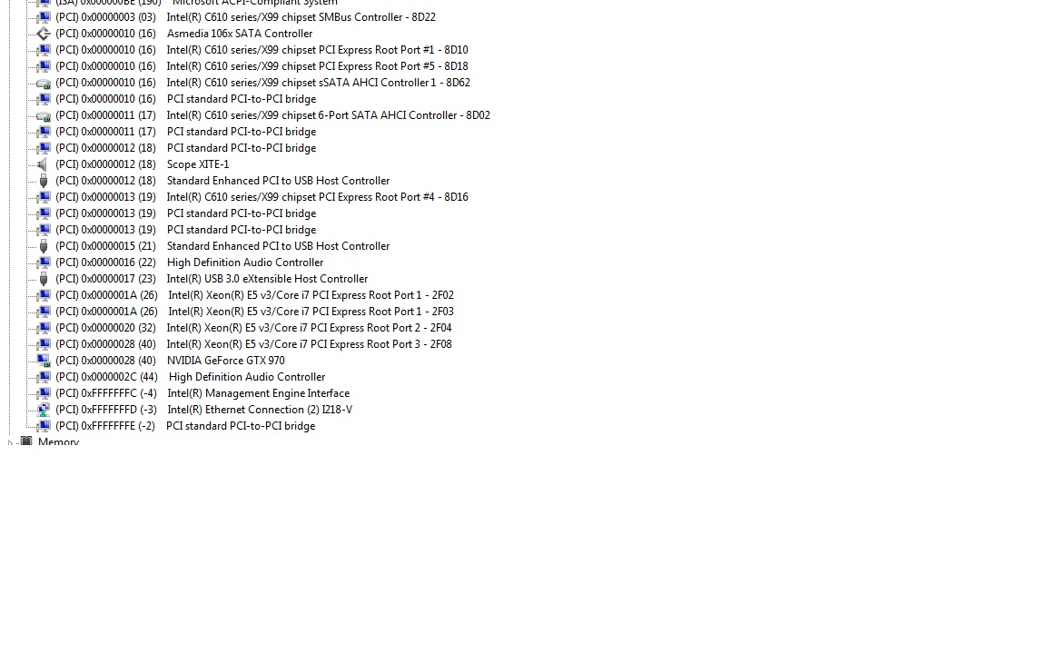

Slot 4:
IRQ Slot 4.jpg (190.02 KiB) Viewed 6892 times

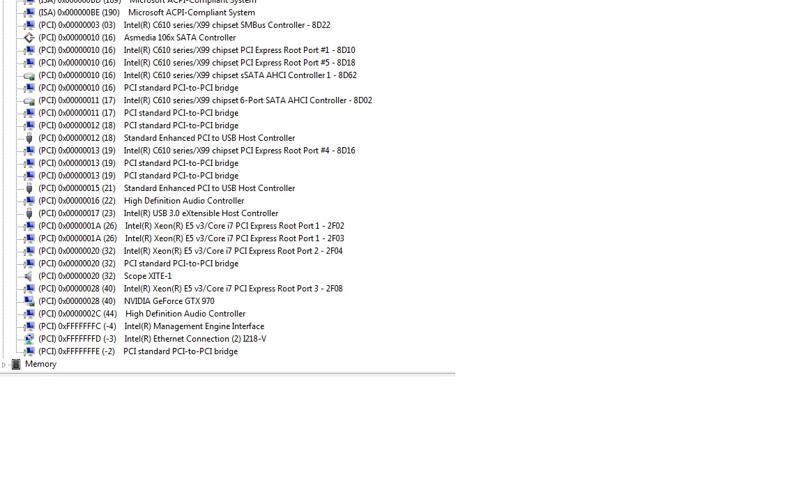

Slot 5:
IRQ Slot 5.jpg (181.16 KiB) Viewed 6892 times
i would guess slot 5.
