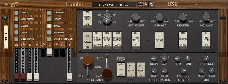

Re: Outputs from balanced I/O very hot! Scope PCI
Just got the B3T Rack Extension for $35. Good value, but I still prefer Selig B3 for Rotor Speed control
B3T
B3T
