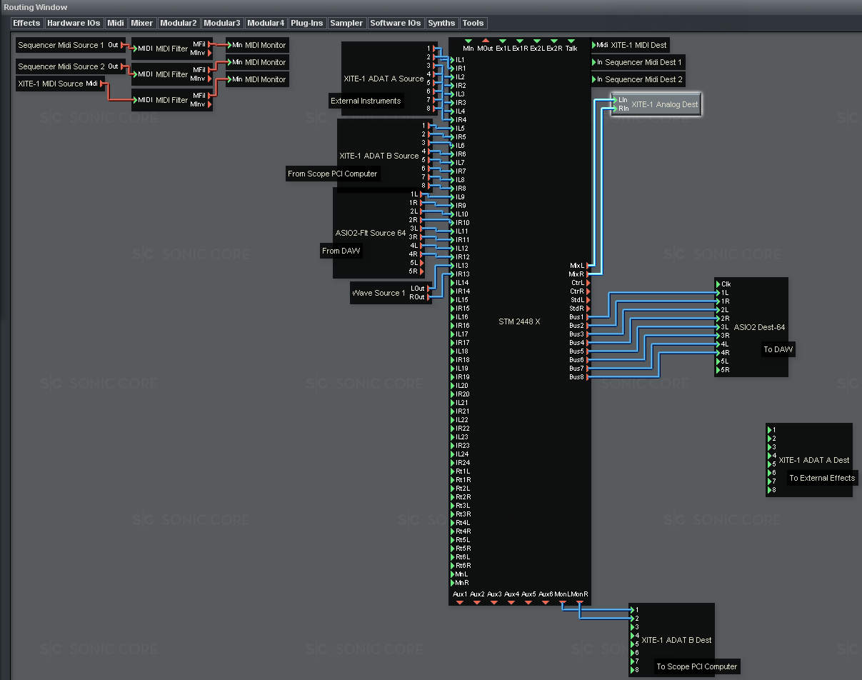

I'm looking for some suggestions of a neat and tidy way to send audio out from my project window to a hardware effects unit and back. Doesn't have to be the STM2448 either.
Also is there any way to attach these labels to the IO modules. I used the notepad feature for these but they are their own entities and I seem to move stuff around quite a bit.
btw the input return would be via the Xite-1 Analog source module.(not depicted)

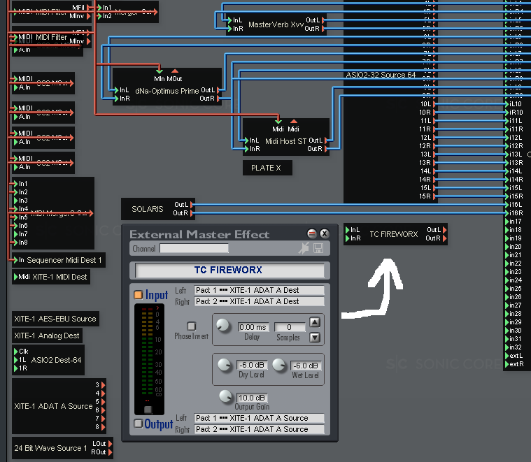

Re: External effects loop
I think You got the point,
But here is my Project with fl studio

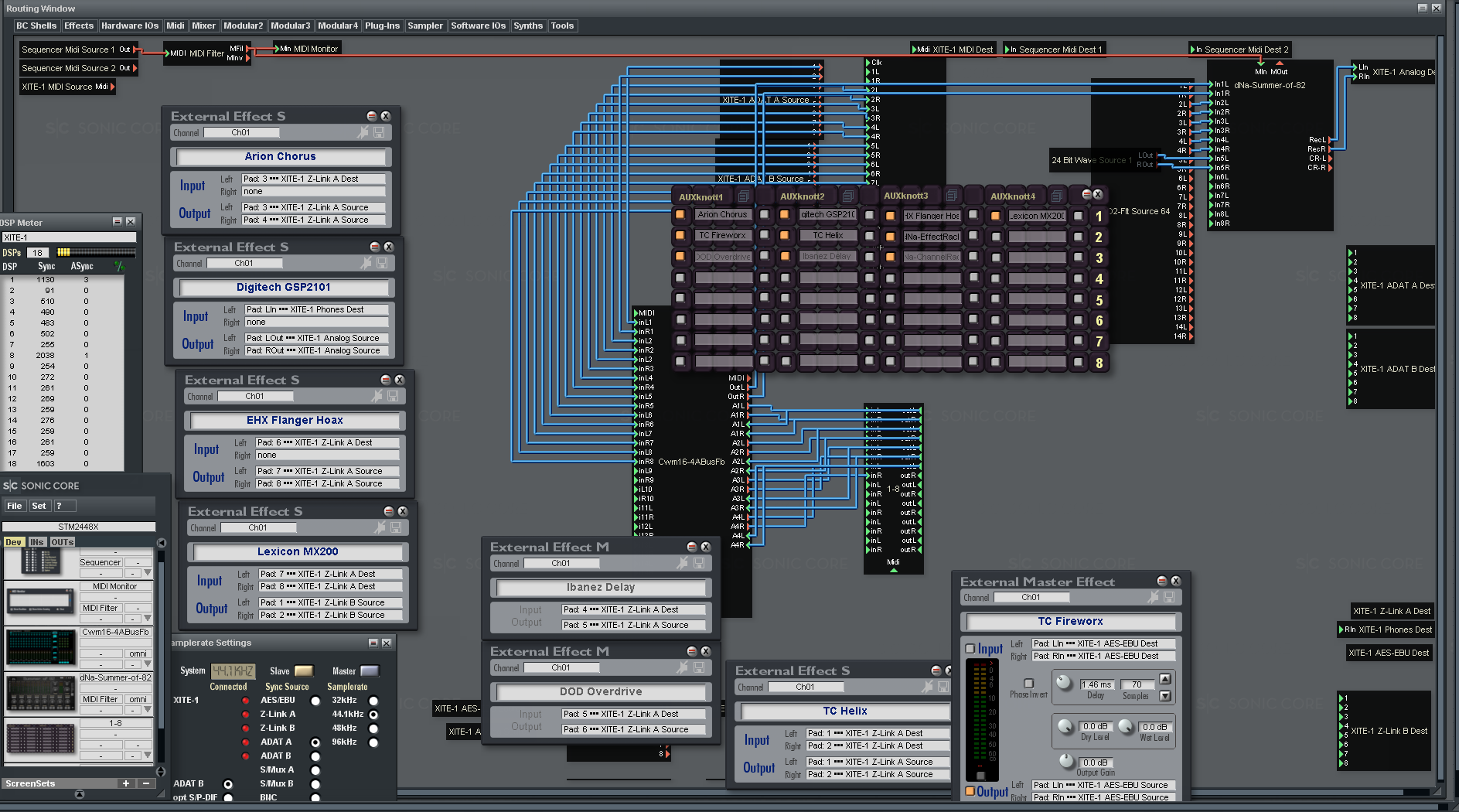

Well as you can see I've accumulated a few more external effects since my original post. I have these all hooked up through an A16Ultra to a Behringer Ultrapatch Pro. After frying my brain trying to figure out the best flexibility routing with matrixes/mixers/aux sends and such I just discovered that I can save my external effects modules in the stereo/mono effects folder and just use them as an insert and when you load them up it makes the connection. WOW! Can't believe I missed that one until now.
Sooo many awesome features to this platform!
