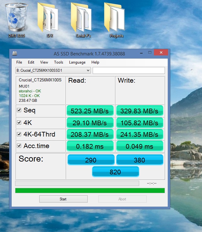

Crucial MX-100s are fast and 100 bucks for the 256GB versions, I suggest these if you need SSDs for sample streaming Kontakt and ujsing Native Syn ths, FX, etc.
I am running at 9% with full polyphony on VB3, PianoTeq 5 Pro, Zebra 2 HZ (Diva Filters from Hans Zimmer and Howard Scarr), Kontakt 5.4. Satin 1.2 from u-He, Melda MRotary and Melda Multiband Saturator across all cores.
SATA3 Bus is 590MBps so the scores shown below are great for such a cost effective SSD.
93,000 IOPs is what I calculated using the division with Seq.Reads. Plenty for our needs.

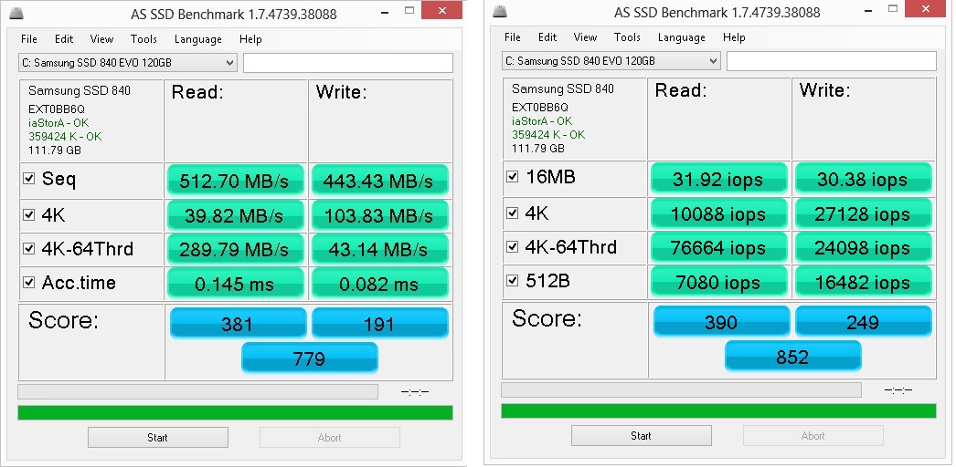

You can get the IOps under the 'View' menu no need manual calcs :)
Samsung-benchmark
Samsung-benchmark
Re: ASRock Z97 Extrem 6 w/ WIndows 8.1 and i7 4970S
True, the iops is not calculated with seq. read throughput though.
For example your Samsung even w/o the caching/boost has a much higher transfer rate, most I have seen are around 95,000 IOps.
It really doesn't matter though as benchmarks can be attained for the sole reason to sell gear.
The Magician software uses from the purchase of that company early last year can show you insane benchmarks, yet there's little effect in real world usage since caching already occurs just from the RAM buffers samplers use as small pre fetch data.
