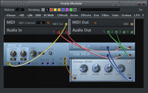

I made just this little patch :
it's a simple midi gate : the sound goes from input to output when a midi note is received. This works perfectly with any other envelope module exept Flexor ones.
If anyone has some time to spend and try it... I'd like to know if the issue comes from my Scope install or from Flexor envelope module.

Hi, you have to connect the gate to the esync on the mvc.
Also when using the mvc c, there's a bug with flexor envelopes in polyphonic mode.
[edit]
sorry, i've seen that you already done that.
I've tried with the "mvc b" and it doesn't work, while with "mvc a" it works.
See the attached modular patch.
miditrig.zip
(760.64 KiB) Downloaded 242 times

if i remember right, MVC-B is fucked up and buggy
