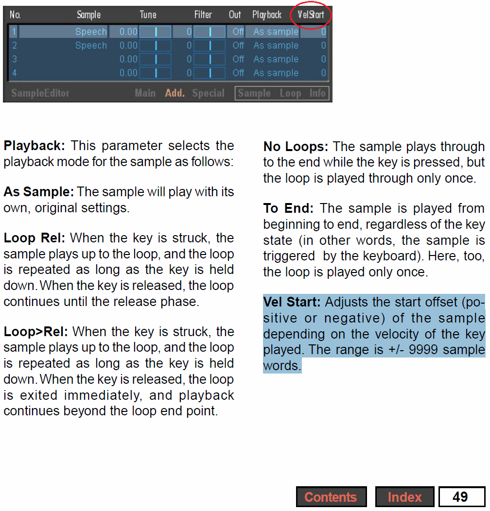

Dude, the S5000 is modeled after the Akai 5/6000, which was why I linked you to a solution for that specific sampler, although I hadn't tried it out. But I have now, and it "kind of" works :)
Here's what's written about it in the manual for the s5000:

wow nice find! :D
actually, I guess I used that couple times and was not quite happy with the results, I wanted something to scroll through a long sample with a modwheel or something with higher resolution, never found it

I hear what you are saying, but I don't think it can be done in the STS5000.

The sts only allows velocity to modulate start sample position and not in realtime but on every key press.
