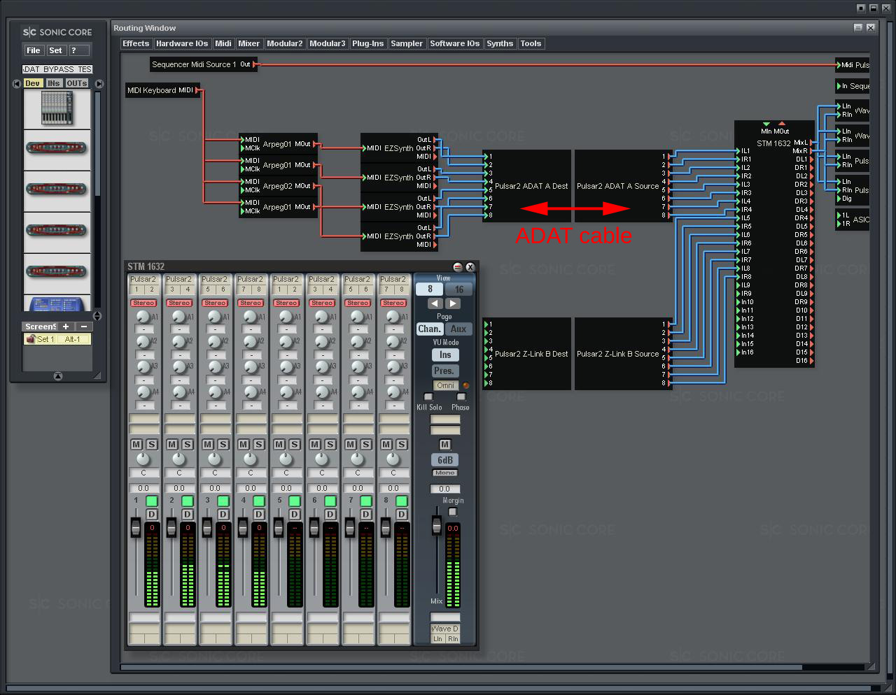

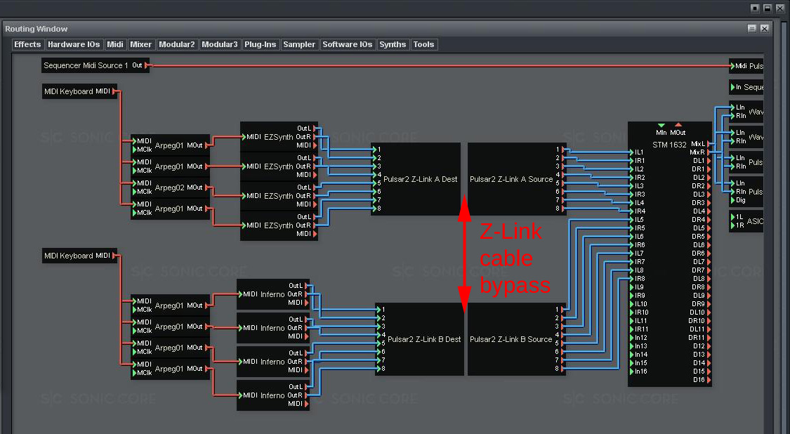

I sell a Z-Link plate here in "Purchase and trade". It is working properly at ADAT side with a Pulsar2. But I do not own Zlink IO-Boxes just ADAT ones. To be absolutely sure selling an working zlink plate, I' plan to test it. At the time I see and can add the Zlink IO modules to my scope project. May I can playback something to Zlink Outs, then bypass both Zlink interfaces with a firewire cable and put, for example, a small scope mixer in between to control the output, or playback the signal as stereo pair at Analog Outs, SPDIF or ADAT DA... Would it work ?

Bypassing the ADAT ports (ADAT Destination and ADAT Source) with an optical cable works fine. See attached picture. Still afraid to do it with electrical Zlink/Firewire bypass...

Should it works like this? Or I'm going to fire up the firewire like Z-Link interface with a bypass? Note: The floppy power connector on the Z-Link/ADAT plate is not connected at the time.

Re: How to test Zlink without Zlink-IO-boxes?
i don't think i'd try that...
- readymedia
- Posts: 48
- Joined: Sun Oct 13, 2013 11:33 am
Yes, I'm also scary about the consequences... It works at the software site, so there is no premise for hardware failure, I think.
me, M6700/i7quad/Win7: PT11/Ableton/Komplete
WinXP/Luna2/Modular2 @Dell630 Dock
- garyb
- Moderator
- Posts: 23474
- Location: ghetto by the sea
well, there's power on the z-link line. that's my only concern.
Immanuel
- Posts: 3018
- Joined: Thu Oct 25, 2001 4:00 pm
- Location: Aalborg, Denmark
I think somebody once tried to hook up two Luna cards through Z-link and fried the Z-link and/or the card.
