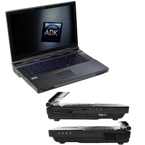

http://www.adkproaudio.com/laptop3.asp
if the 9000x won't do the job, what will?
I'm sorry - not really my kind of woman. I'm picky that way ;)

That ADK 9000x is a desktop in a laptop case, btw.

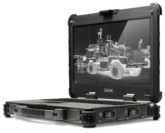

Logic would be Cool but look at the Getac Laptops.
If those aren't sexy show me something that is.
Thier Express Slot cartridges lock in professionally, not loose like consumer models.
