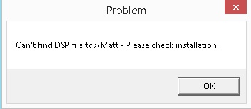

A problem I had loading MasterIT EQ due to DASCOEFF11.sys not loading, seems now I have the same issue with MATTOMAT file tgsxMatt.sys.
Latest versions (x64) in SYS folder, but will not load.

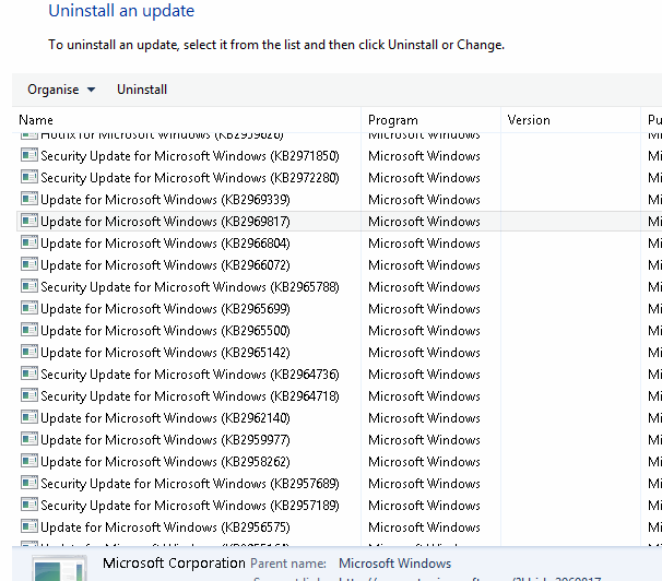

Fidox resolved the problem by rolling back Windows 8 Security updates to a pre April 2014 state :

It took me a lot of time, before i figure out that spring update for win8.1 causes me troubles.
I'm still running without that update and scope works fine.

In my case, it was spring update for Win8.1, so i un-installed this update and everything works perfect.

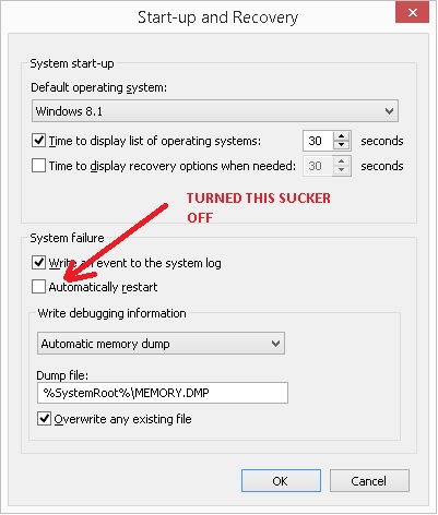

Apparantly they created the option to reboot on failure rather than BSOD, then set that option as default !garyb wrote:ok, so what has m$ done?
http://www.troubleshootwindows.com/wind ... -vista-xp/
So thats the next thing to try I guess....just to get crash dump.
Re: sys files - issue on latest Win 8 x64
Turned off the auto reboot on crash, now system doesn't reboot on load of sys device, it just looks ok for a few seconds then hangs.

I have the same issue in Windows 8.1 x64. In my case is with Solaris Plugin and Matomat.
Usually it will restart once and then it will accept both plugins without issues. The first times it needed more than one try to get stable.

It all started, when i have updated Win 8.1 pro 64bit version with spring update KB2919355.
First , there was an issues "Slow loading-opening folders in Windows Explorer".
There were also other users with this issue, but they don't use Scope platform , they're just Win 8.1 users and not musicians.
So , we manage this to work, mostly with fix , creating new user account in Win 8.1 and it also works for me that time.
Then i installed back Scope and noticed that DASCOEFF11.sys causes me troubles, freezes, no matter what i have done.
I un-installed KB2919355 update and now everything works fine, couple months already, with not a single freeze or similar.

And therein lies the problem for me, since KB2919355 and dozens of other updates are dated the day WIN8.1 was installed from the DVD (27/JUN/2014). I click on it, and the uninstall option disappears. I suspect, on my DVD, KB2919355 is part of the build, not an installable extra.
