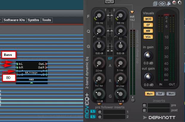

I often need those kind of fx. You could use free MOVEQ on your bass with your BD on the side chain.
Your bass arrives in inL & inR. The device exists in mono.
BD is on side chain. In the image, I set both bands to cut low frequencies to get more result but one band mays be enough. You can adjust the attac and release with the envelope follower.
MOVEQ is awesome for this kind of job.
