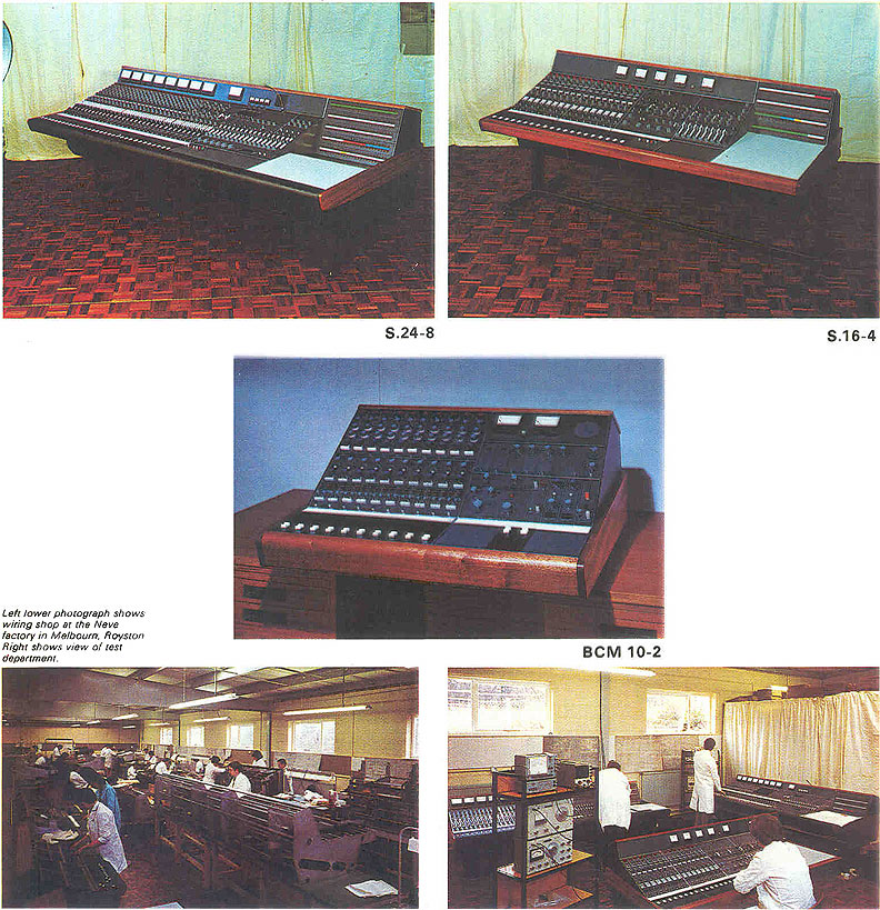

ex neve employee and now retired makes and designs tube only mixers with passive eq and tube make up gain with summing bus and master bus
most things were point to point wiring and they used lots of metal shielding and input and out transformers for noise cancellation
its easy to build a diy neve products because they came with schematics so that engineers could fault find on site when engineers were that they were electronics specialist and sound specialist they learnt about acoustic theory and about sounds and how to lay them the passive inductance circuits for eq have crosstalk because of the interactions of the magnetic fields but they sounded so good but you do get a lot of volume cut and so this has to be made up to the same level as the input by a make up gain stage
worse cross talk comes from the panning circuits on the fx returns where the left and right channels can bleed into one another
but even on paper in designing when you make the product it never performs as it does on paper due to heat components used and quality of the electrical supply
and to emulate inductance via a native plug in is nigh impossible so its all relative using the same type frequencies
its the same with most emulation unless you are actually doing circuit emulation down to the resistors opamps or discrete circuits as is the case with the older neve products where the opamps where created by hand with match components dbx being the most famous one the blackmer amp vca
so to me as i use analog processing and make the diy pro audio versions and can tell you the plugs dont come close in sound or operation and why there is a big community making new and improved versions of the same 50,60,70,80 pro audio gear
like ian who is making new tube mixer designs but using top grade 1% resistors and wima caps and sowter or mag or other transformers for better crosstalk and noise suppression
as the top drawing shows his new ez mixer channel goes beyond the neve cnannel with pre and post eq and routing options i have built several channels of this channel strip with the red47/rs eq and the meq5 eq and the helios eq and a summing box and the difference in sound to a mass produced opamp based 1 pcb design like mackie is over whelming

Awesome pics jhulk ....!!
Re: crosstalk and other console emu things
Now I know where Roland got the idea of scientists in white coats for their 10,000 USD V-Piano video.
