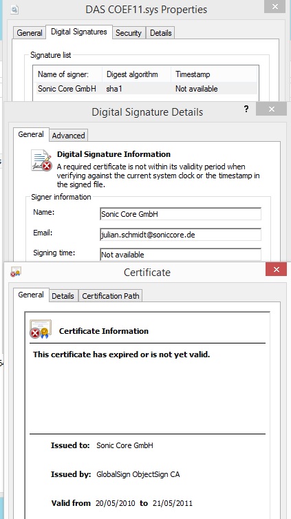

Does it matter if the certificate has expired ?
EDIT: I just ran an bcdedit command to turn DEP off & rebooted. - no effect

EDIT : I just found the following post from Fidox : http://forums.planetz.com/viewtopic.php?f=1&t=32720
Ill check with Vendor that they installed from CD then applied the spring update. If so, we have a hot suspect. If the CD contains the update, I'll demand a base Win8.1 CD.
So looks like a re-install of Win8.1 from the CD the vendor supplied is the next step. Hopefully that CD is pre Sping Update fidox mentioned (April 2014) http://support.microsoft.com/kb/2919355 contains security updates so likely affecting filesystem access you could be on the money there GB.fidox wrote:Like I suspected and already have some issues with this new update for Windows 8.1 64bit. I un-installed spring update for Windows 8.1 (KB2919355) and re-installed Scope drivers again and everything works just great now ! No freezes or blue screen !

Just spotted on:
It's a new system incompatibility that Microsoft introduced with that Update, so your problems should be communicated to Microsoft. But the software that is no longer compatible is Scope, which hasn't gone thru Microsoft certification. So you'd imagine that it'd be back on the developer (DAS in this case) to involve themselves in the fix.Important All future security and nonsecurity updates for Windows RT 8.1, Windows 8.1, and Windows Server 2012 R2 require this update to be installed. We recommend that you install this update on your Windows RT 8.1, Windows 8.1, or Windows Server 2012 R2-based computer in order to receive continued future updates.
