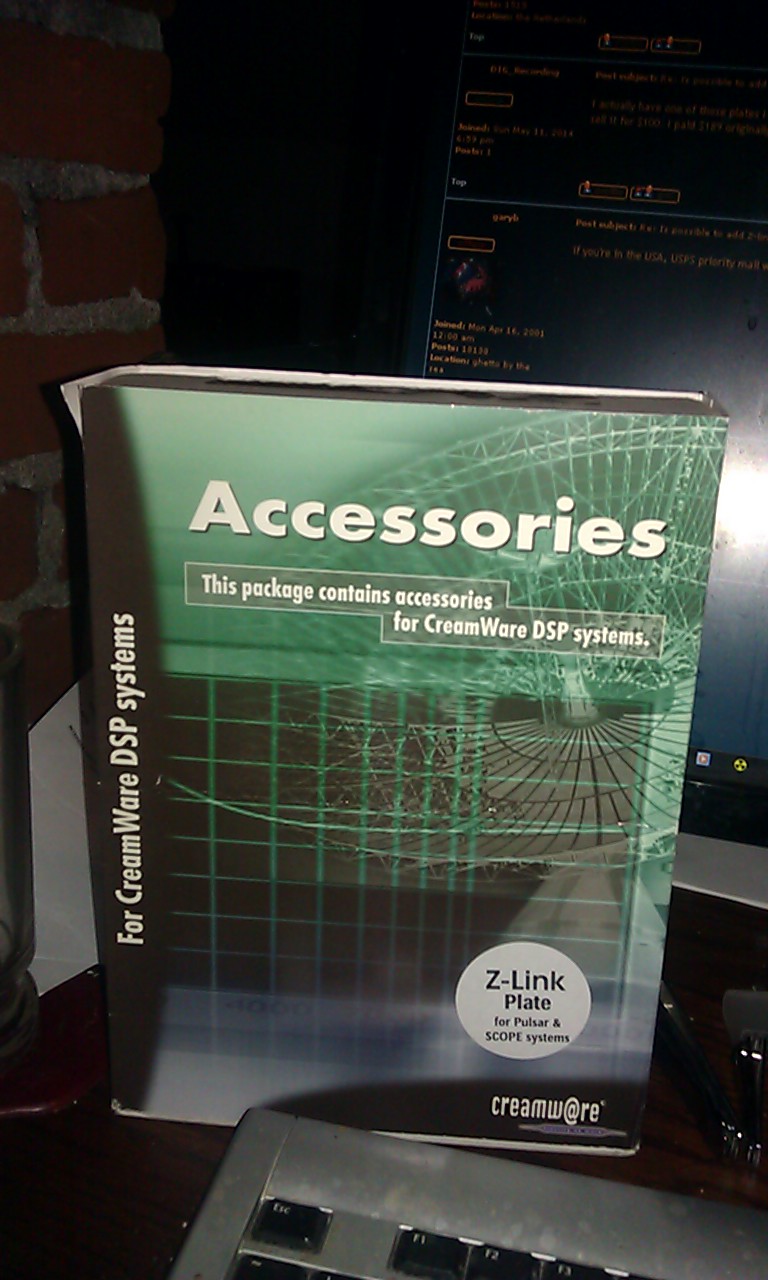

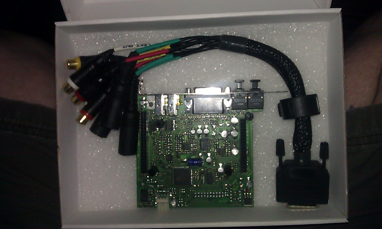

Thanks for the info. Sounds like it's not a big deal. Attaching pictures of what I have. It's available if interested. I'll probably post it on the sale part of the forum in a few days if I don't hear anything.
- Thanks
- Thanks
- Zlink box.jpg (411.65 KiB) Viewed 3047 times
- Zlink Plate.jpg (401.89 KiB) Viewed 3047 times
