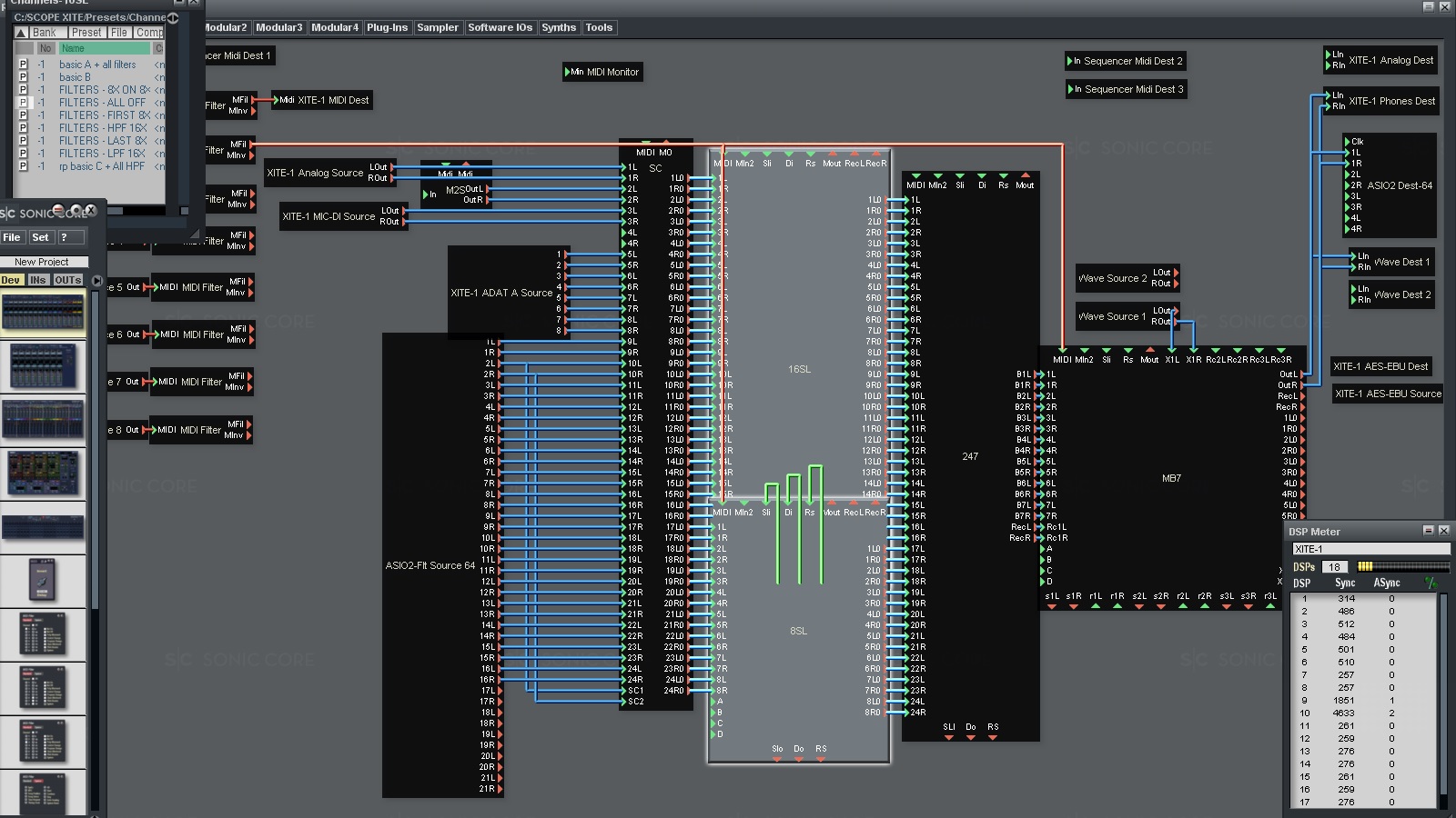

RP_001
Posts: 233
Location: Netherlands
Re: Dsp 9
Post by RP_001 »
Nice find Fra77x! I managed to get more SAT connections indeed, using the modular mixer(s) on DSP9 only. Before, I used 2x 12SL modular mixers, each on different dsp's (7&8 or 8&9), but I couldnt load the 16-channel version without having sat errors. The Sidechain (24ch), 247 Stem and MB7 parts are assigned to dsp 10. I noticed I couldnt load all of the sidechain channels though, around 80-90% which is more than Ill ever need. The dsp meter shows 1821 for both 16SL & 8SL for dsp 9, which leaves plenty of headroom for filters and insert fx. When needing even more, I can also assign the 8SL to a seperate dsp (11), without having SAT errors. Time for further experimenting and optimizing my project window, as I really like having one big 16SL mixer. Thanks!

fra77x
Posts: 889
Re: Dsp 9
Post by fra77x »
Great!
To be honest i was talking about dsp 10 in the normal software because in the sdk the enumeration starts from 0...
So... cool! Dsp 9 (8 in the sdk) also offers some more communication... I will check it..
