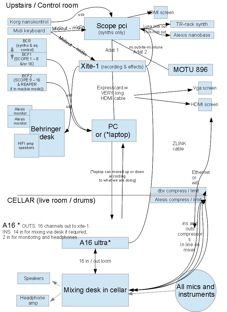

thanks - and a good question - basically i have two rooms....and want to be able to only have to move the laptop when i work in the other room rather than having to move everything....so i thought that running a long cable into my other room might be the most obvious solution which also saves me having to set up a 2nd pc just for remote desktop etc..
see attached file to see what i mean - top half is my ' control room', bottom is my 'live room' cellar...i sometimes do my own drum playing recordings donwstairs alone so need to be able to control the xite1 when downstairs..a case of wanting my cake and being able to eat it..anywhere
when you tried the 5 meter test did you use a specific ' quality' brand of hdmi cable, btw?
