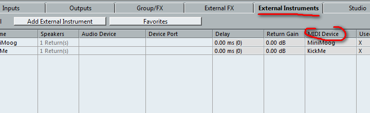

Hi to everyone. Synthesizers (MiniMax, U K. 007...) drift (especially noticeable on high bpm). Treated? Sampler does not want. How will the people ever bass (and all other) on analog use? Floats awful

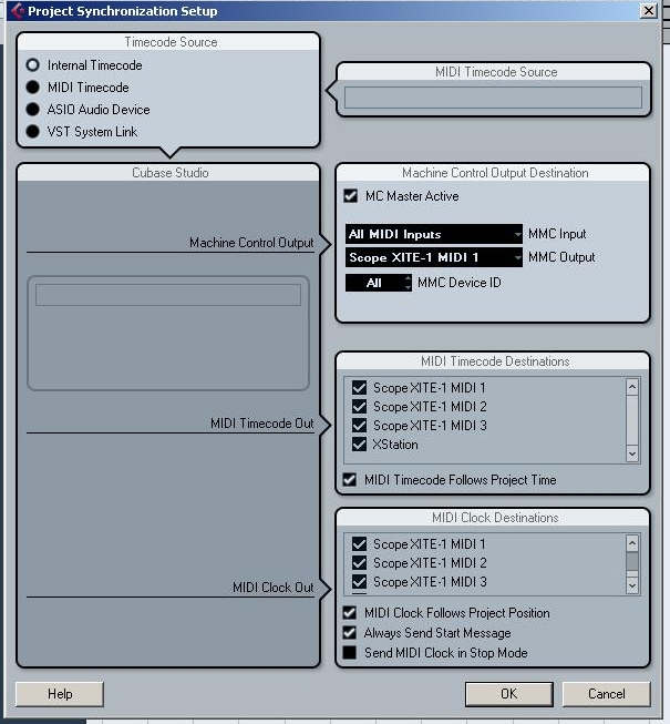

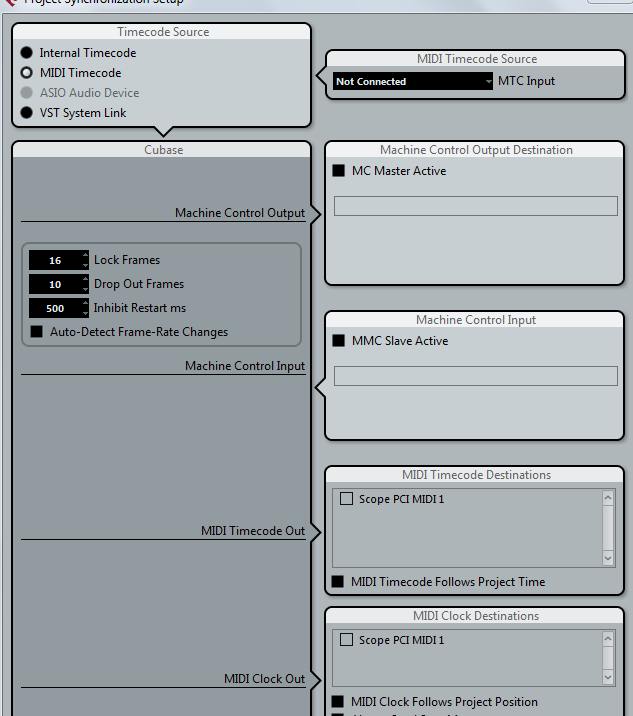

Try changing Timecode Source > MIDI Timecode to Internal Timecode. Maybe that what you mean but it is hard to understand what you want. But I hope that helps.

what do you need midi timecode for?
for kick me and minimax it's not needed.
For other tools such as arpeg02, you only need midi clock and there isn't a timecode option, so better you don't send timecode where it is not required.
You don't need to add scope devices as external instruments, it's enough to control them over midi ports from the sequencer.

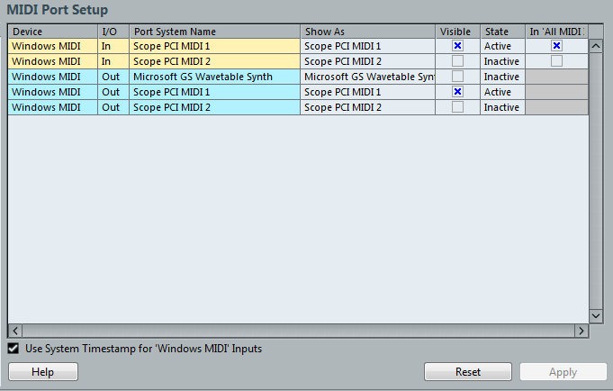

did you check "use system timestamp" in the midi menu in Cubase?

daw - cubase, audio driver - scope asio, samplerate - 44.100, midi - "External instruments", next MIDI Device (without the out-of-sync).

i never use external instruments settings and i use midi in Cubase from Scope all the time.
Re: Synth drift
Yeah scope can do that routing no need to do it in Cubase

Here's how my Project Sync Set-up window looks. Also, do not use External Instruments.

If not External Instruments.. how? I want to use a mixer Cubase. thank you
Re: Synth drift
Personally I never use Cubase's mixer. I route via ASIO from Cubase into a Scope mixer. You can plug all your Scope synths and effects into the Scope mixer. You can then feed the result back into Cubase for recording. There is no latency this way.
