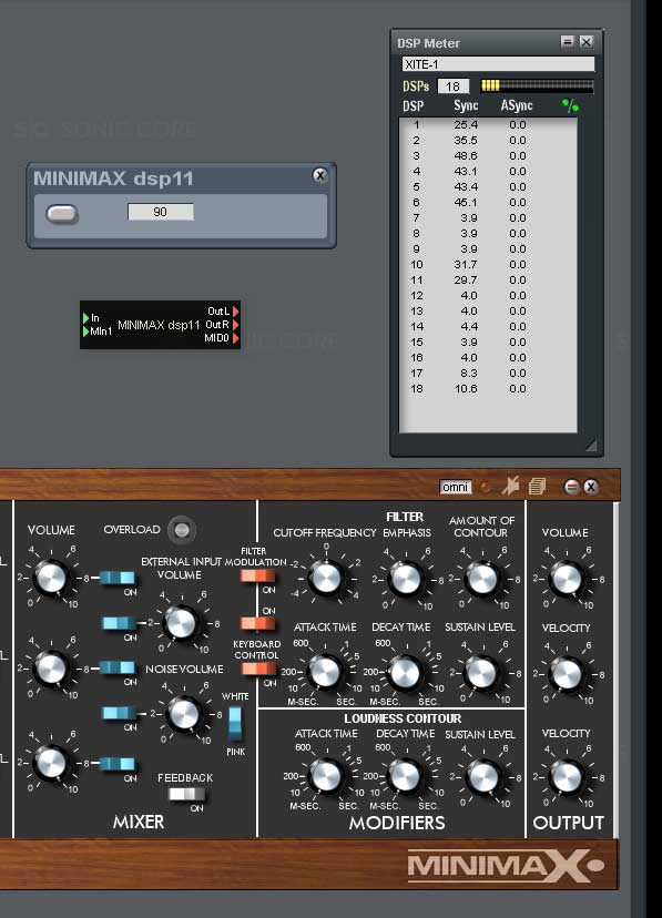

I'm converting some devices to be loaded straight on specific dsp.
The list will grow as i convert them.
Here the download page:
http://goo.gl/x4qeAQ
The use is simple, the modules have the dsp number on the name, and synthesizers have also a fixed polyphony set on the module.
Once the module is loaded, open up the surface and push the button to open the main device surface as devices are protected and the only way i have found to open the original surface is to use midi cc sent by the button of course.
The default cc for opening surface is 116, but you can change it.

- dspoptimized.jpg (60.99 KiB) Viewed 6239 times
