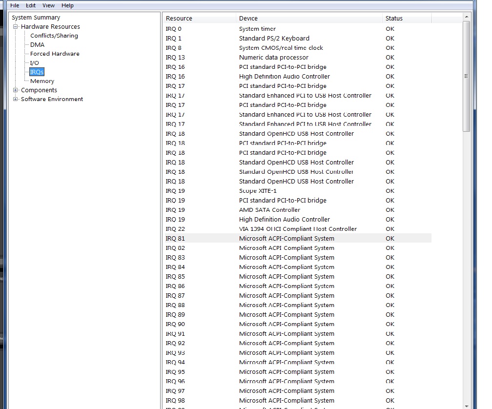

As for BSODs, have you checked your IRQ Sharing?
I got some BSODs, worked thru IRQ sharing, disabling what devices I could, and have fixed the issue.

I updated the files with the Zarg 64bit ones! while loading a preset for ambient I had to browse for a sample and bang a BSOD again !.
Ambient is looking for a sample in an old sfp/samples directory! should I create it((folder) and put the samples there?
its looking for THING A Rs when I load that file from SCOPE XITE/Samples
- IRQ
- irq 9.23.13.jpg (228.78 KiB) Viewed 6967 times

every preset without sample files works great in Ambient! and the IRQ looks good ? its time for more Beer!!!
