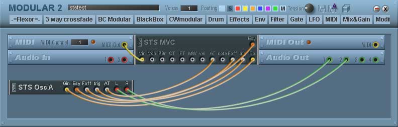

Never used it,
just done a quick test.
Check the attached patch.

yes thats the simplest one
use the button on the side to open panel then choose an sts file
it should play now
it should play now
