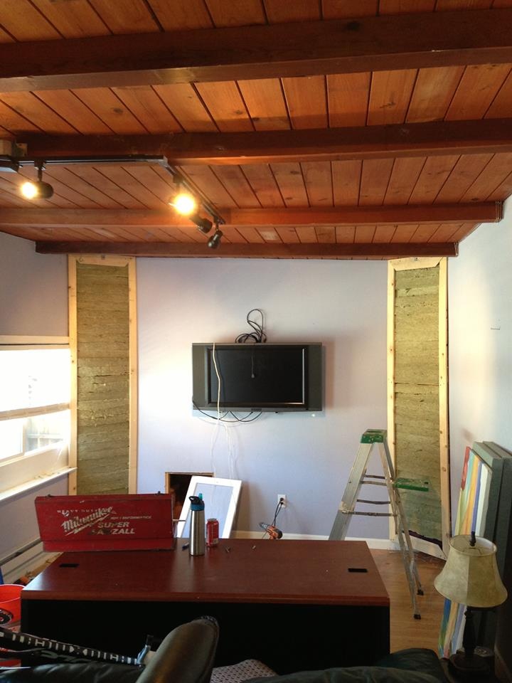

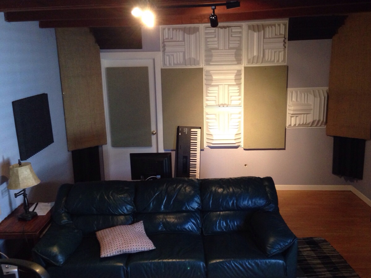

I am treating my studio to improve its sound see photos. I picked up a load of matrial from a studio that was going out of business 10 703 rigid fiberglass panels a load of auralex foam panels,bass traps and 6 T'Fuser diffusers http://www.auralex.com/sound_diffusor_t ... tfusor.asp I also bought Roxul mineral wool and have built two super chunk bass traps for the front of the studio
My questions is should I use the T'Fuser in the celling gaps between the wood beams this seems like it could be a problem area? Or use them on the back wall. I plan to fill them filled with left over mineral not to sure we're should I place the diffusers?
The room is 9ft by 24ft insulated drywall walls exsposed 8ft wood celling and wood floor
- image.jpg (162.9 KiB) Viewed 3038 times
- image.jpg (136.86 KiB) Viewed 3038 times

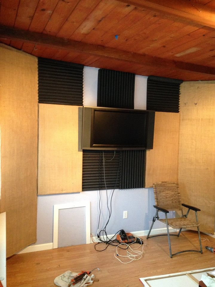

just figured this out ! I was at the back of the studio and there is a lot of bass back there! was going to skimp on the back of the studio and use foam bass traps but will now build two superchunk traps like the front

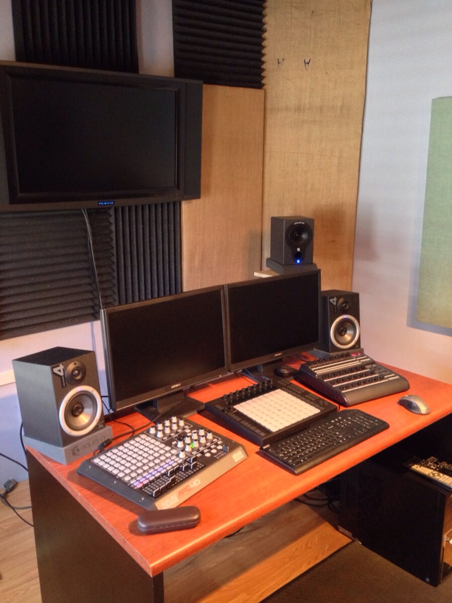

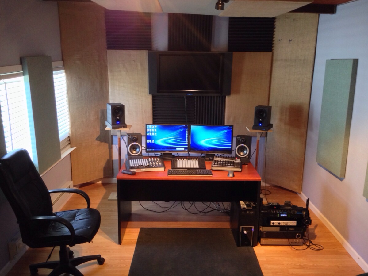

So nearly finished it sounds great bass is good and stero field much better !
- image.jpg (251.64 KiB) Viewed 2832 times
- image.jpg (230.42 KiB) Viewed 2835 times
- image.jpg (230.89 KiB) Viewed 2835 times
