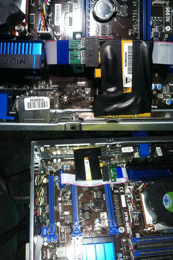

I connected the XITE-1s PCI-e 1x connector to the PCI-e 3.0 16x slot and it works perfectly.
This doesn't help with DSP placements or anything like that, but sure does allow endless polyphony with endless sustain pedal being down, which use to overload the buffer.

I should have done that but it's in the 1U and racked up now.
I do have a jpeg. of the ribbon extender I use and when it was hooked up to the PCI-e 1X slot below.
This shot only prooves how stable the XITE-1 works using the extender and a 1U, and also over a year now of gigs w/o using a GFX card.
The GPU of the Ivy Bridge is more than powerful enough to handle DAWs and Scope together, and I am only using 128MBs of the RAM.
256MBs being the maximum option in the BIOS of the MSI Z77A GD65.
I love Duct Tape as you can tell, and used another piece of thermal 3M Tape to cover the 16X exposed pin connectors.
Next time I blow out the 1U Chassis, I'll remember to take some shots of the PCI-e 3.0 slot all connected.

Re: PCI-e 3.0 16x Slot
So you have taken the XITE-1s PCI-e hostage with duck tape
Looks good and inventive.
i think that tape is insulation to avoid shorts.
Well I finally had my first crash during a gig, and it turns out the direct connection to the CPU using the 16X PCI-e 3.0 protocol wasn't such a great idea.
It worked for hours here and while I knew that tranfer rates, and bandwidth wouldn't increase, I was willing to try the .01 msec. latency that PCI Express offers.
This might be a bad idea afterall.

Re: Don't Try____ The PCI-e 3.0 16x Slot
i think the biggest problem is the small connector in the big slot. it can make a sloppy connection.
when you're in a 16x slot with a 1x card, it's a 1x slot.
