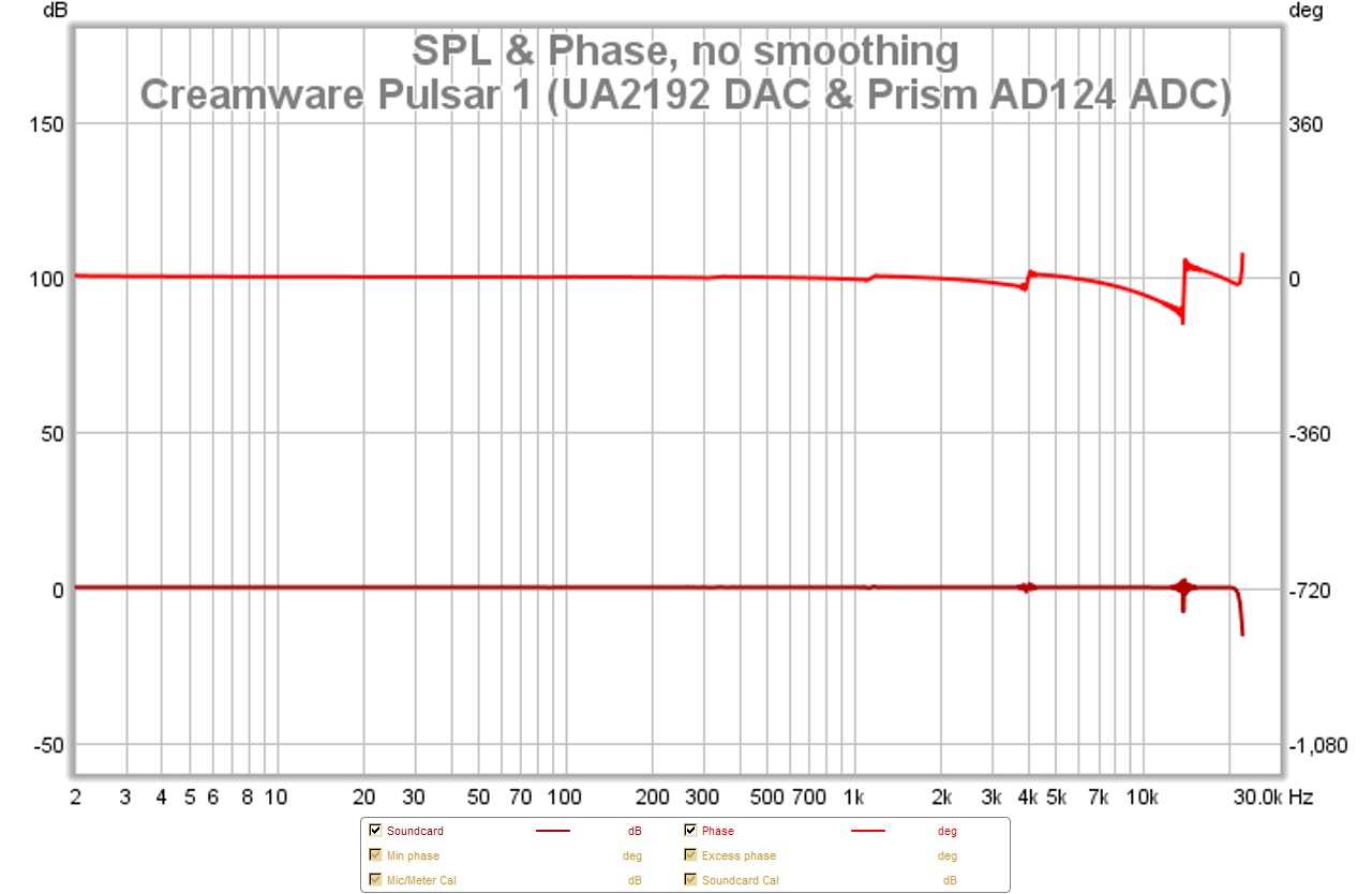

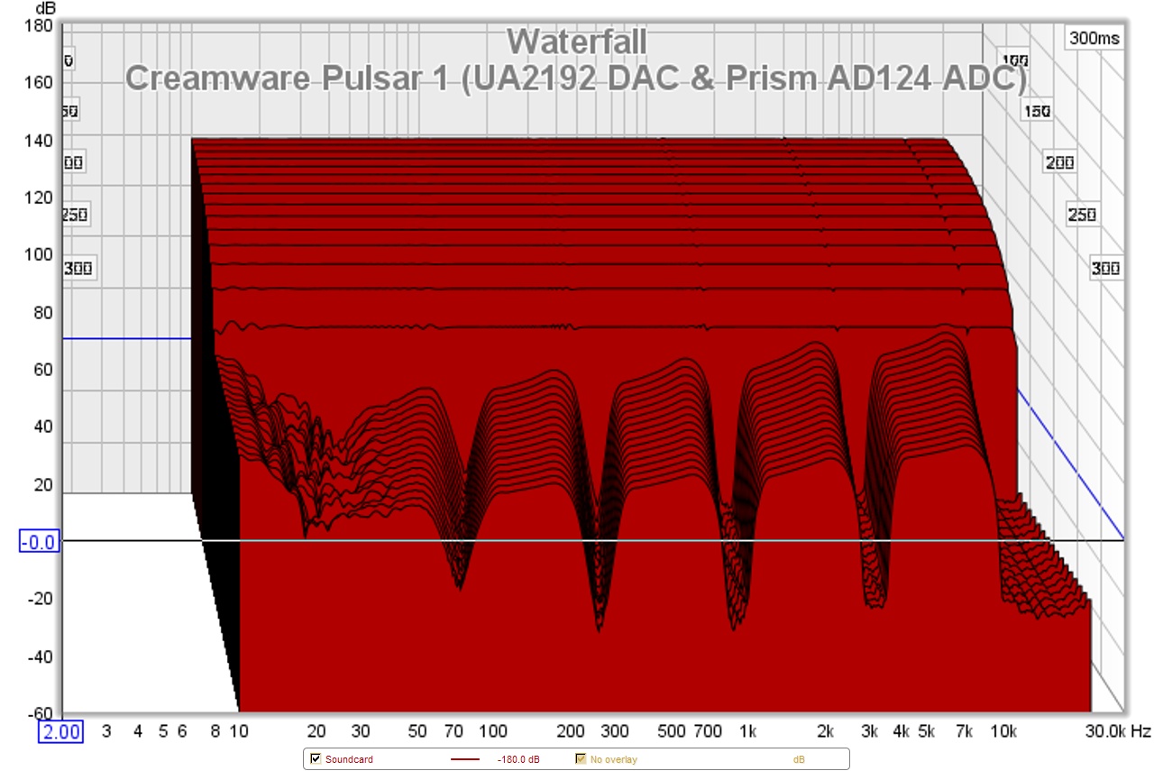

So I did some measurement of SPL and Phase response doing a loop from card to UA2192 to Prism AD124 and back. The card is clocked from Prism AD124. The sharp 6dB ripple dip is at 13khz.
creamware pulsar 1 (ua2192 dac & prism ad124 adc).jpg (287.31 KiB) Viewed 826 times
creamware pulsar 1 (ua2192 dac & prism ad124 adc) 2.jpg (151.94 KiB) Viewed 826 times
