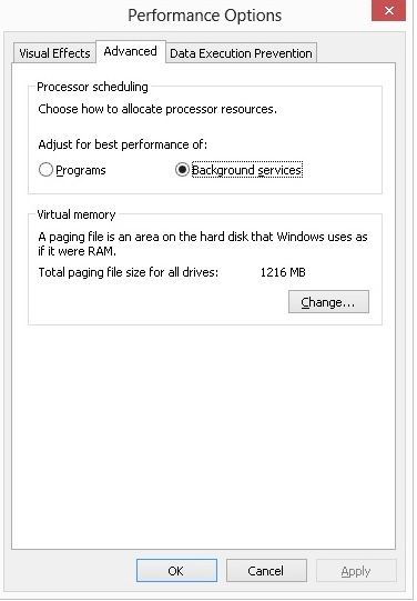

Did you set the audio priority to background process (rather than applications) in control panel advanced performance ?
guppy
- Posts: 407
- Joined: Thu Aug 16, 2012 6:42 pm
Re: Win7 32bit install and crackles
Yes thanks Dante, I've set it properly
