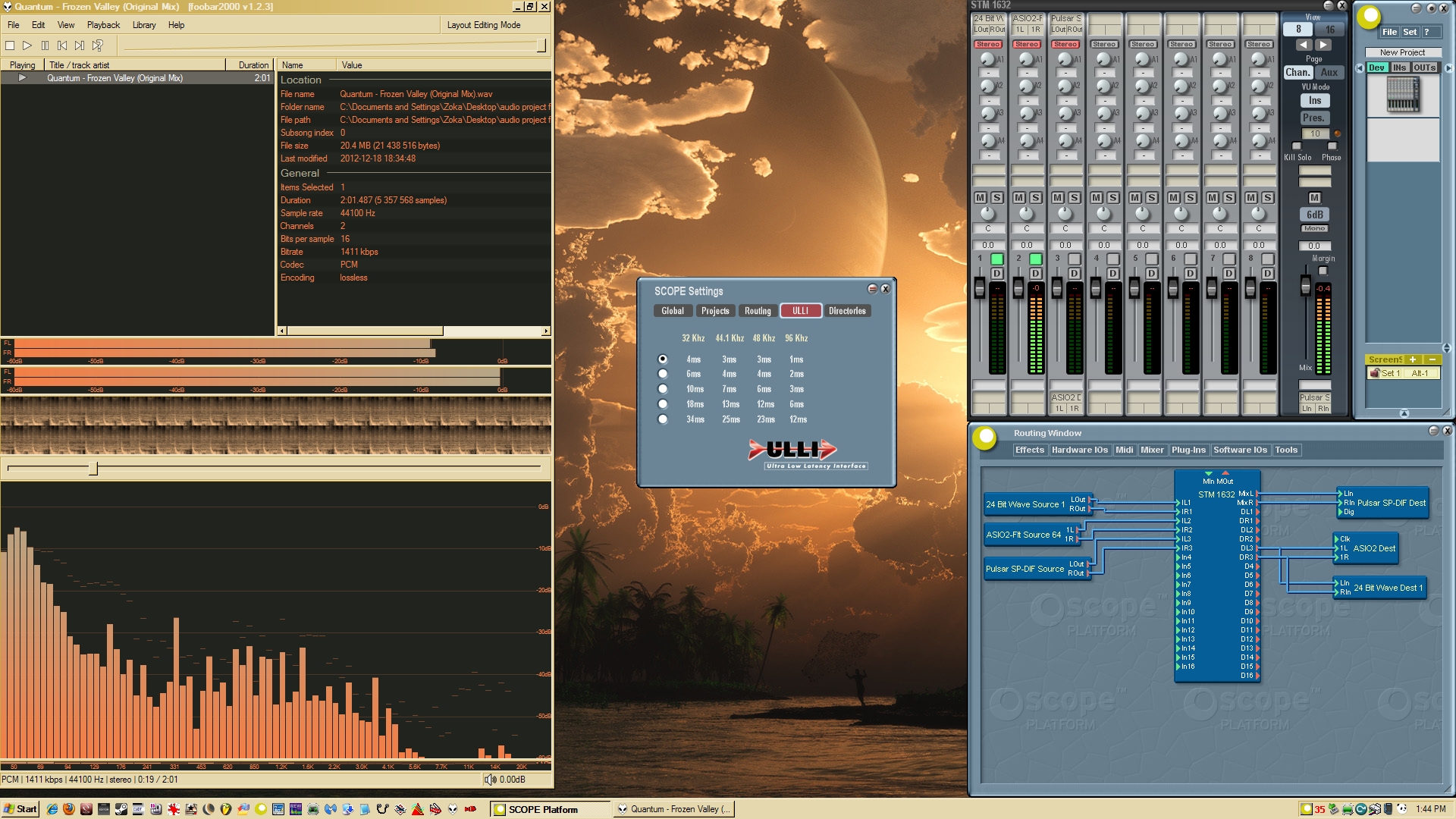

In my system with one SRB expander, the Pulsar 1 goes all the way down to 3ms using ASIO, granted I start getting underruns in FL Studio, but for recording and playback only I never get a hickup. I have the professional verison of Scope 4.5 installed and XTC mode turned off.
Pulsar 1 latency.jpg (1010.1 KiB) Viewed 1595 times
