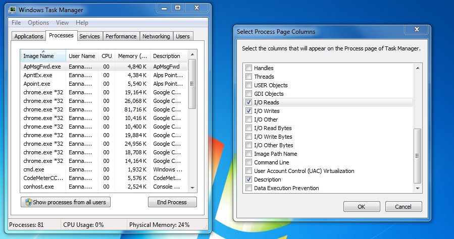

Any process in Task Manager other than Cubase seem to chew disk?
Have you switched off indexing on the drive?
Ensure the latest drivers for your hard drive.
If you're not using standard Windows SATA drivers, consider switching to the default drivers.
Check AHCI driver too. And make sure DMA is switched on for your drive.
Anything interesting in the Windows Event Viewer?

If windows starts with normal disk load, and then hits 100% when you start Cubase, then it must be a Cubase problem on windows 8.

I'm sure there are many hits in Google to help diagnose high disk usage. Eg if you are loading a big project that is larger than your ram, then you will hit the pagefile on disk a lot. Hence why I asked if an empty Cubase project has the same problem.

You have to try to prove (or disprove) that this is a Cubase 7 application problem.
Does an older version of Cubase show the same symptoms? How about Reaper, using the same ASIO driver?
If you remove all third-party VSTs and VSTi's from Cubase before startup, does the problem stay? Is everything except your keyboard, mouse and monitor disconnected from the PC? Does Windows behave well (the disk usage is low) for a medium-to-long period (say over an hour) when Cubase is -not- running? At what point during the running of Cubase does the high-disk issue arise? If you open Cubase 7, do nothing with it or you computer for a while, does the problem happen? Straight away?
Any newer / beta versions of Cubase available?
If you launch Windows Task Manager, and in the View -> Select Columns menu, tick the "I/O Reads" and "I/O Writes" checkboxes, then sort by those columns, making sure to click the "Show processes form all users" button on Task Manager, then you'll see the top processes causing disk access.
Make sure too that all the memory installed in your computer is available to your programs, that Windows reports that you have the full amount you expect. If RAM memory is tight, then you could be page faulting the hard drive alot! There's also a checkbox in that Select Columns dialog for Page Faults - you'll want to keep those numbers low.
Another thing to consider is whether there are updated drivers for anything available for your system. I'd check the latest available drivers from the Microsoft HCL (Hardware Compatibility List), or something like those listed here:
http://forum.maxthon.com/viewthread.php?tid=50676
Thinking specifically of your SSD driver (if one was supplied by the manufacturer), and your BIOS. But Be ULTRA careful with these! It's OK to check if you're up to date with your system and kernel drivers, but don't apply any changes without understanding that these are LAST RESORT options!!
If you can prove that it's an issue with Cubase 7, then maybe with the name of your SSD, your Windows Build Number, Driver details, your Cubase preferences, and a complete picture of when the problem occurs, you may be able to get some better from the Cubase or the Windows 8 forums...
Take care, and good luck
The switchover to AHCI is not causing you a problem. SSDs will work with IDE, but are more efficient in terms of data transfer when using AHCI mode.
If AHCI was your problem, then you would see new, different behaviour (alot worse than a busy-disk Cubase problem!). As it is, you haven't fixed the issue, nor have you made it worse. So, I would be inclined to leave AHCI alone, and to move onto other avenues to find the solution.
Did you change to AHCI mode via the BIOS or thru Windows? If you changed it thru Windows, the only way I know to do that is via the Registry... In that case, you might consider rolling back the Registry to a recent point in time before you performed that edit. Be careful tho! The BIOS setting for SATA using AHCI and the Windows driver to support that setting influence each other! Hence why I say, leave it alone unless you are sure that you have a GUARANTEED rollback or backout strategy, if that change goes wrong.
And, obviously (I hope!), back up anything you need off that drive now!
