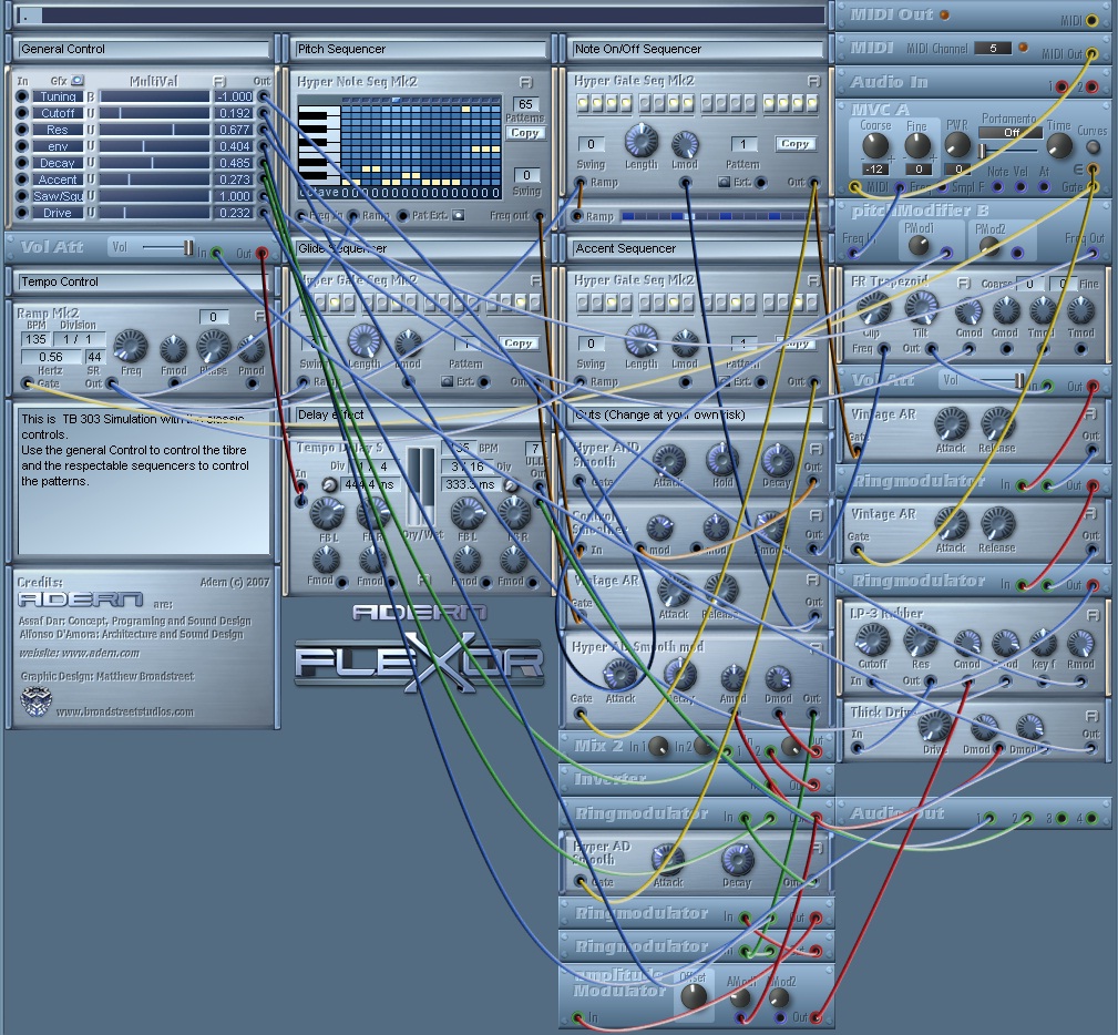

Hi I want to modify a very good Flexor patch, TB free-ofree.
It is a patch with many sequencers, 1 for note 1 for gate and 1 for accents.
But i want to use the MVC for all that, and i have problems integrating the complex Accent feature.
Basicaly i have modified it to run with MVC-pitch and gate, but i need some sort of Velocity-split to trigger the Accents.
There is the picture of the original patch:
TB free-o-free.jpg (388.67 KiB) Viewed 3319 times
I hope some Modular-Master will be able to help me, so i can learn more of this synthesistricks!

As you can see the Accent sequenzer is triggering a Hyper AD Smooth, which is then connected to some Ringmodulators and a Amplitude Modulator.
I somehow need to connect the Vel of the MVC to a module which would trigger(per gate) this AD when a chosen velocity is reached.
In other words, i need a module which is spliting the Velocoty of the MVC into two regions, of which one should control the gate to the Hyper AD Smooth for Accents.
Thanks for any help.
Manuel

Ok so i experimented a bit and found a solution.
You can download the Patch here: http://forums.planetz.com/viewtopic.php?f=15&t=31681
Have a look at the Accent circuit, creative minds will maybe find ideas for similar circuits.
Maybe a nice destortion on higher velocitys, or....
