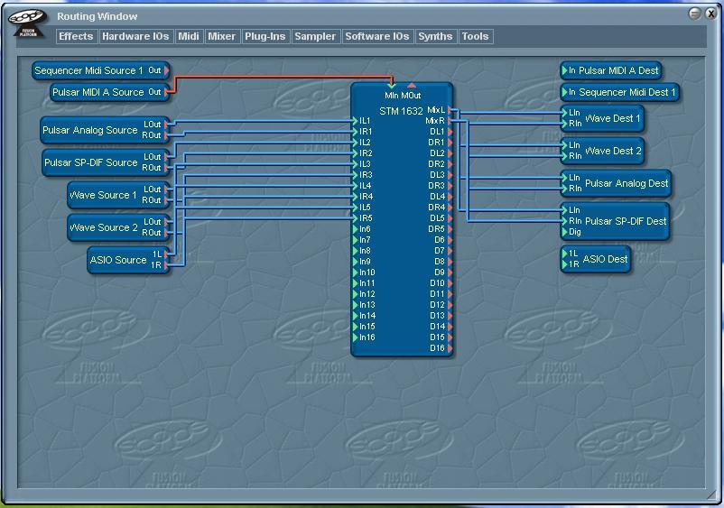

post a screenshot of your routing window and the audio settings in Cubase....
Re: Help please! Pulsar and Cubase problem. Error messages.
Thanks for replying. I cannot enter Cubase yet, error message screen problem.
But here is my routing window, its the default.

strange, there doesn't seem to be an issue....
