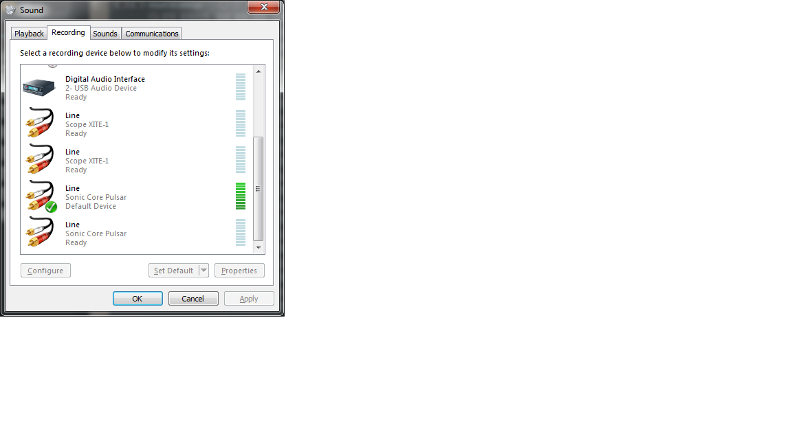

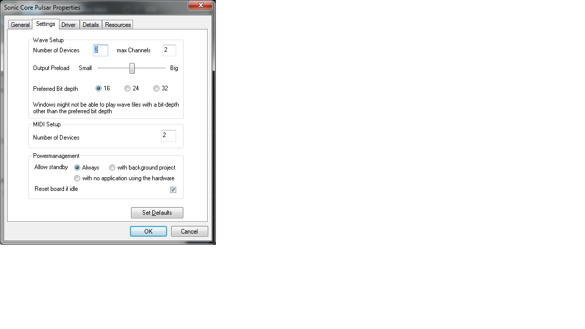

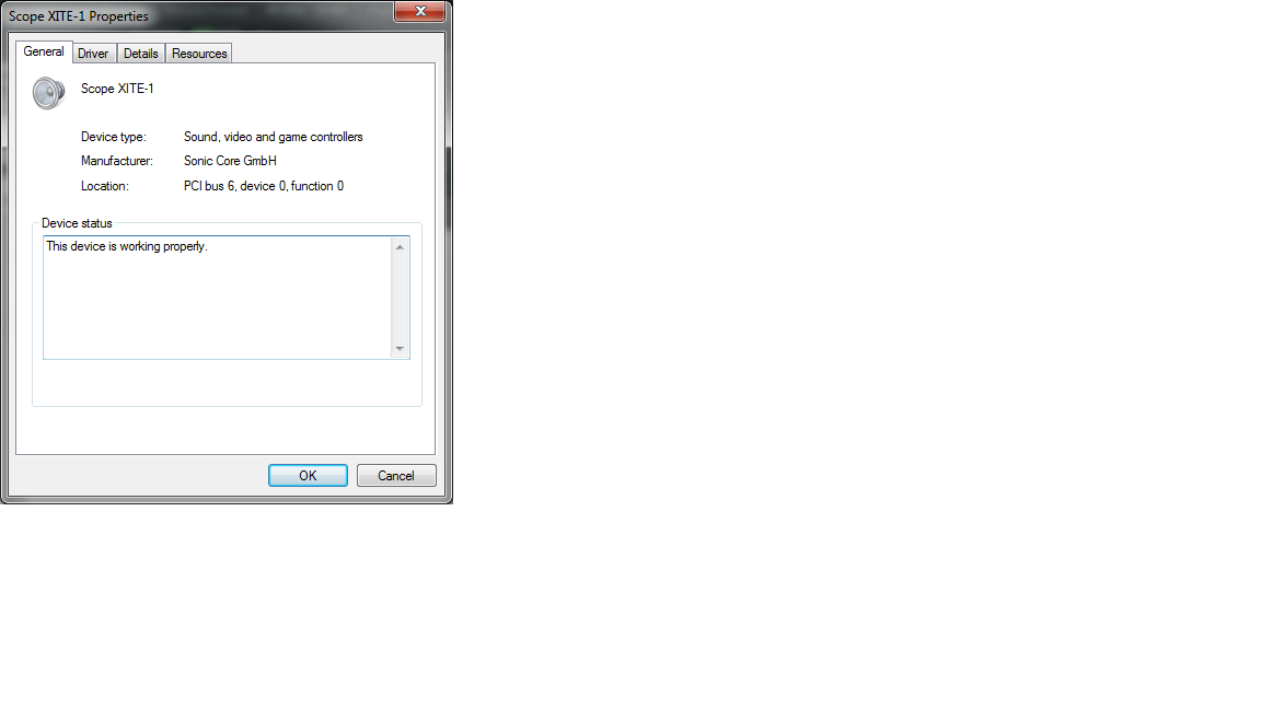

I do not have any clock visible in my desktop since I don't use the Aero desktop or whatever gadget platform that is. Is that the same thing than opening sound prefences from control panel? I can do the following to access the choice you are referring to: control panel - sound - recodinggaryb wrote:again, right click on the speaker icon near the clock. the setting are there.
be sure to have 2 wave source and dest modules(i use 24bit) and connect the source modules to the mixer, so you can tell which provides sound. i belive windows prefers the second set of wave modules. they will be called "Scope XITE-1 speaker" or something similar in the windows 7 settings. i'm not in front of my machine, or i'd give more detailed descriptions, but they DO work, DEFINITELY.
When I click Scope XITE-1 - properties - properties - change settings I can see the view in picture xite-properties.png
When I click Sonic core pulsar - properties - properties - change settings I can see the view in picture scope-pci-properties.png
There you can see that I cannot access the settings from XITE drivers. But in the Scope PCI driver I can adjust the number of channels, bit depth etc.

- Control panel Scope PCI settings
- scope-pci-properties.png (54.04 KiB) Viewed 2582 times
- Control panel XITE settings
- xite-properties.png (50.38 KiB) Viewed 2582 times
- Control panel sound recording panel
- settings.png (76.2 KiB) Viewed 2582 times
Re: operating system sounds
it's on the last screenshot. "recording" is the tab for sound going TO the app from the card.
you need the "playback" tab.
ok, i see that, sorry.
i see the XITE's wav dest modules available....it does work here.
