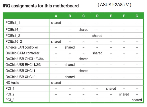

I have found this AM3+ Board but PCI1 2 & 3 are sharing with ?? E F G ?
ASUS F2A85-V.jpg (71.46 KiB) Viewed 4444 times

According to this, they dont share at all.. they have all dedicated.
no other device used thoes..

so it is looking pretty god for my three pulsarIIs.
but again 270 euros.. for experimental PC buliding.
