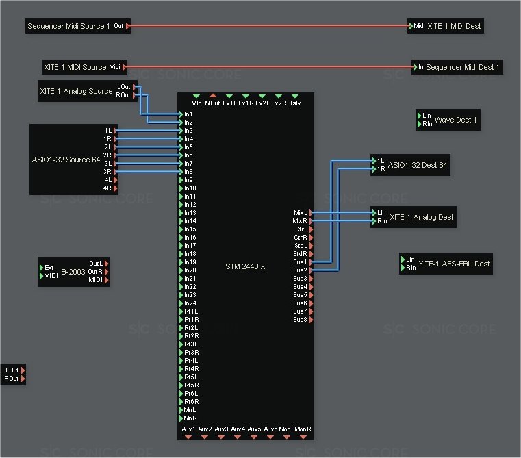

Sirius here is my project and specs:
I'm running W7 64 on intel i7 2600 3.40GHz
GA-Z68X-UD3R MoBo
8Gb RAM
ASUS Graphics GT520 1GB
No previous issues experienced. I could disable a few peripheral ports, USB2 and 3 etc.
May be it's a Samplitude thing. I should may be contact them.
This is true but my problem is switching from XITE MIDI to LPD8 as the [All] doesn't work. Switching off is OK. Re enabling however doesn't work. So if I want to do some drum tracks on LPD8 for example, then switch to some keyboard, at the moment the only way is to completely close Sam and Scope then re open to reset the drivers. I was hoping MIDI-OX would solve this problem. I feel Siriusbliss could be right. The MIDI to Scope is not affected. I had the B-2003 connected just to check for that.
GA-Z68X-UD3R MoBo
8Gb RAM

Samplitude will see all MIDI ports no matter if you use MIDI-ox or not.
But I use a korg NanoKontrol (USB) as a small live mixer for Scope, which is why I use MIDI-ox as well as a PadKontrol for playing/programming drums running USB directly into Samplitude with no conflicts.

oh sorry, if the LPD8 doesn't have midi out sure you need to use the virtual midi driver.
Re: Kontakt 5 to respond to LPD8
@djmicron: The LPD8 is a USB only device. It shows up as LPD8 IN and OUT in the Sam MIDI settings. Does that need MIDI-OX?
@siriusbliss: May be if I'd bought a combined keyboard and pads unit I wouldn't have this problem. However I'm not looking to perform live or such. The only reason I bought it was to do some real time drum tracking and a little mixer automation. So it's not the end of the world, as it does actually work, just not seemlessly with the XITE MIDI ports and Sam. Also I'm new to MIDI programming and have a lot of experimenting to do. It could be that I have overlooked something.........!
And your other question: 'Does Samplitude see your LP USB input without Scope running?' Yes it does.

it depends on what you need to accomplish.@djmicron: The LPD8 is a USB only device. It shows up as LPD8 IN and OUT in the Sam MIDI settings. Does that need MIDI-OX?
If you use it always in samplitude, then the midi loopback software is not necessary, but if you want the akai to control something inside scope without using samplitude it can be useful.
In short, inside samplitude, you select the usb akai as midi input device and it should work.
If it doesn't there must be something wrong, maybe the samplitude midi setup?

DJ is correct.
Samplitude should see the USB device directly, so just make sure you set up Samplitudes MIDI input device to the LPD.
You would ONLY need MIDIox if you later decide to trigger Scope devices from USB instruments.
