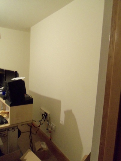

The Auralex T-Fusor 600mm x 600mm 150mm thick - I would put four of these up on the back wall but they are 150mm thick so when they get to the level of the desk it means the desk has to be further out. the wall in question is 2150mm high from the skirting board (above floor) to where the ceiling joins so having 2x2 of these diffusers would come down 1200mm from the ceiling and the base of these diffusers would be at desk height or lower slightly
Auralex also do a mini diffuser which is 304mm x 304mm 123mm deep so these could go in other parts maybe. There is another side wall other than the wall opposite the speakers but lets deal with things one at a time..... :) .....
The wall is 2380mm wide approx. The surface is hard - plaster with emulsion-great to stick something on...
Pic from door.jpg (542.38 KiB) Viewed 2134 times
Here is a pic taken from the door.

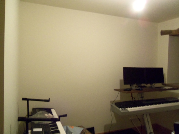

Here is the opposite wall where the speakers will hit.
Opposite wall to speakers.jpg (575.86 KiB) Viewed 2130 times

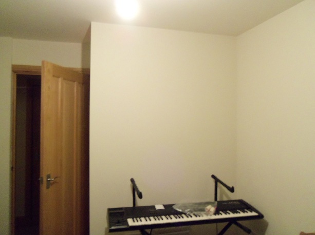

This is the window
Window pic.jpg (574.41 KiB) Viewed 2130 times
Opposite window
Inside the room will be an office desk 1400mm wide 800mm deep plus 2 x keyboard stands and two PC's. The desk has 2 x 4U Racks on top where the speakers stand on Auralex foam product. Speaker stands could be bought if you think this is not good enough....

Opposite window - I put this here as I could only load 3 attachments.... :)

OK Gary and others if you're interested..... :) ......done some calculations for the back wall - if it is best to have 4 diffusers then they can go central-ish - then to either side of the four diffusers can go 3 foam panels which are the same dimensions apart from depth....
So on that wall in the picture above will be 4 X diffusers and 6 foam panels - Is it best to put 4 diffusers instead of 2??? -
Then 2 diffusers can go on ceiling - very close to the diffusers on the wall??? any gap?
This covers most aspects of the room apart from two awkard recesses 1 sq metre each to the right of the doorway as you look in... but these could be useful to store some manuals etc... extra diffusion....??? -
Re: Studio Monitor Technical Comparison - MSP5 & KRK Rockit
if you put one on the ceiling, put it over your head.
one bertween the speakers, two behind you close to eachother and one on each side of you is probably about as good as you can do. put the foam on the outside of the diffusers behind you and on the side behind you. that's what i suggest, anyway...
for mixing, it's best if the speakers are away from the wall, but of course, practicality is importantr, too.
