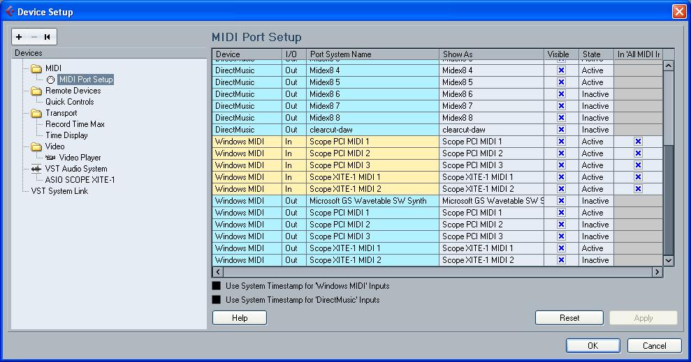

Hi, I have some midi problems for a while that i want to solve now.
First problem is, that i have two midi ports selectable in cubase which are named differently everytime i open cubase, so i have to reconnect the midi tracks to one of the two scope midi ports.
Do you also have two midi ports selectable in your daw, or is one normal?
I think i heard sometime, that there can be problems with midi ports, when one installed different scope versions without deinstallin. Does someone know if this is the problem?

Posts: 5089
Re: Strange Midi Problems!
Im able to address 2 different sets of Scope ports in Cubase without any problems. But the 2 versions of Scope are active. So Im not sure if I removed one Scope version if Cubase wouldn't know its not available anymore.
Either way, its possible and not unusual to have many MIDI ports in Cubase. Of course, if you have 2 Scope MIDI input/output ports registered in Cubase, that will only work if you are running a Scope project with 2 'sequencer midi source' / 'sequencer midi dest' modules active and connected.
Posts: 23474
the number of midi ports that show up in Cubase are determined by the setting in the card's properties in the device manager. 2 is default. of course, to use both, you must have two pairs of Sequencer midi modules in the routing window BEFORE opening Cubase.

Ok so its not the problem that there are two ports, but why do i get clicks when i route midi to cubase?
Everything with the routing works fine and i can play vsts, but it clicks( like when cards share IRQ with USAB ports).
This is true for every midi conntroller i own, so it must be scope who is causing this nasty clicks.
Also why are the two midi ports named differently each time i open cubase? I have to manualy reconnect cause of that.
For example: I work on a project where a midi track in cubase is routed to a scope synth. The midi output in cubase is called "4-Scope PCI MIDI 1".
Then when i stop working on the track i close everything, and when i start working on the track again cubase tells me that this midi port is not found.
In cubase i must than take the midi port that has suddenly changed his name to "Scope PCI MIDI 1".
I hope i have explained it better now.
I defenitely have opened and routed everything alright, the problem is that when i open cubase it searches for midi ports, and it seams that the scope ones are called differently everytime i open cubase.

Posts: 23474
i don't think i've ever seen that. something must be mucked up. that's not normal behavior. there is no standard "why" answer.
this is only a question, because it would seem there are strange bugs in Cubase, are there any cracks on your machine?
