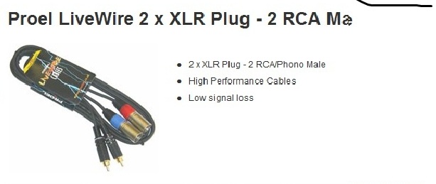

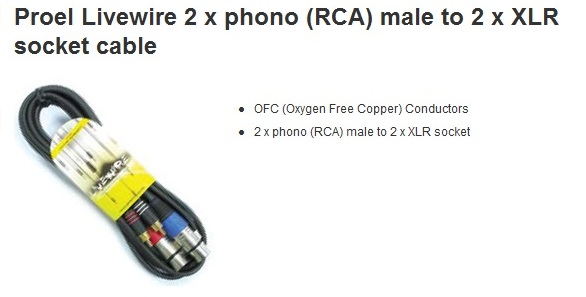

For the L/R out & L/R in I've found these cables:
phono xlr plug (male) rectangualr selection.jpg (31.38 KiB) Viewed 1500 times
and
phono xlr female cropped.jpg (33.81 KiB) Viewed 1500 times
I've only got one set of what you would call a good speakers/monitors Yamaha MSP5 and there is an option to coneect with XLR or TRS at the speaker itself.
The digital cables I've got are coax and optical but neither will connect with the Scope Pro or Xite-1-
