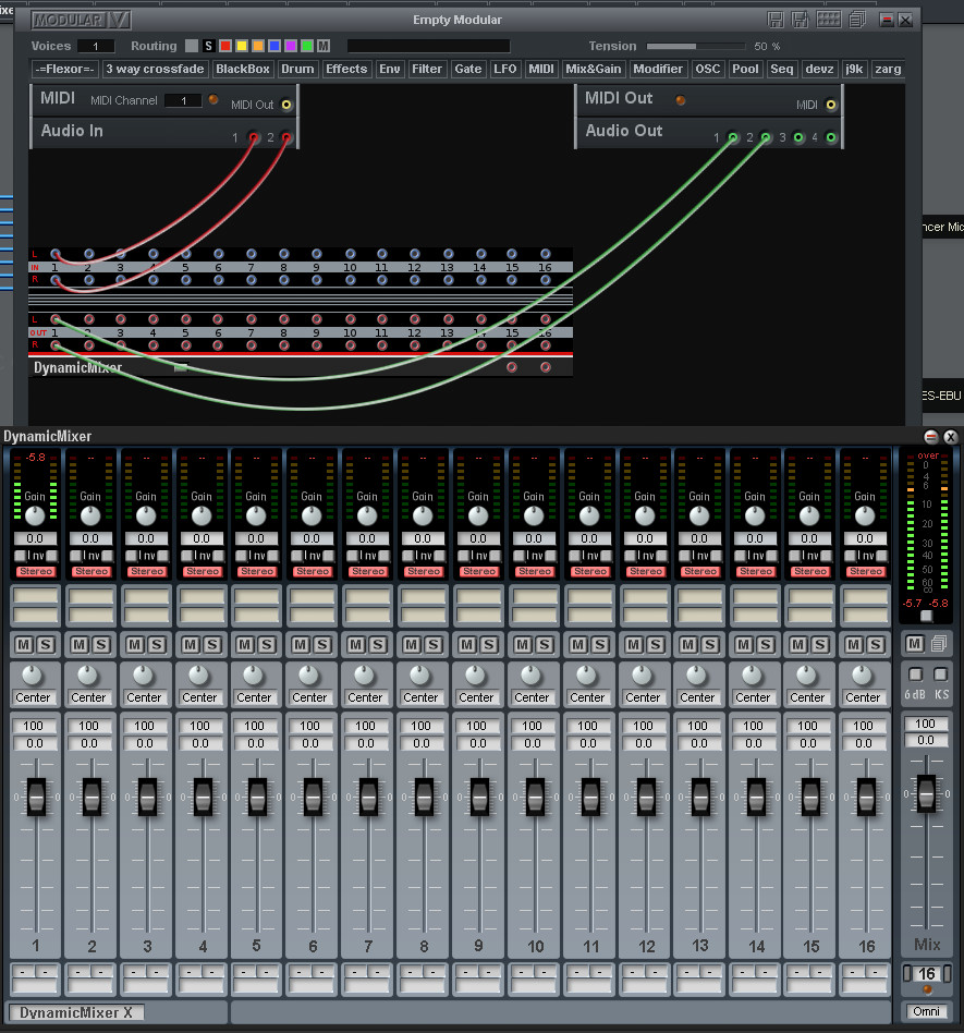

dynamic mixer modular adapted
scope v5 needed
any modular version is fine
this mixer uses dynamic pads and this doesn't work inside modular, so:
the first time you open the dynamic mixer it has everything enabled, all stereo channels are on, but if you switch a channel to mono, it will use only left channel
this is ok, but if you switch back to stereo, it will not restore the channel on the right.
Needless to say, before of saving the modular patch, be sure you have the right mixer configuration, then it will work flawlessly.

Dearest DJ of Micron.
I have audio functioning perfectly.
B2003 channel 1, Minimax channel 2, Prophet V channel 3, and two external audio in's that house my SE-1X Analog Synthesizer.
To see the GUIs for each unit, I have CC71 for the B2003, CC72 Mini, CC73 ProV and CC74 for the Dynamic mixer.
I cannot get the GUIs for the Mini and ProV once I save the Modular Shell.
It works OK until something in the porject window is saved.
And whenever I recall a project it always say that 6% of the presets are compatible, check yes to continue.
I hope these tidbits help out, as I really love the small sized Project window, and small mixers I can use.
I am using the old SpaceF C2 w/ no direct outputs for live, and I love that little mixer.
Dynamic Mixer is perfect as I can use Inserts, Gain/Trim, and Pan. I rather like sending a snapshot of a mix to the mixer where only effects and volume need adjustments, if any.
Thanks
JAV
are you using the latest devices i've sent to you?
do you remember that the cc you are using now are in conflict with your external controller?
Re: Dynamic mixer x - mod
Actually the numbers I sent you are my options that I have to use on every project.
I changed the Drawbars around and they are assigned to buttons now so the faders can be used for mixing, and effects sends, etc.
I have the B2003 and Dynamic/Micro Mixer working like charms.
It's the GUI buttons on the Minimax and ProV that work for a little while and then no longer respond.
I have each Shell now set to Omni, and the devices then have their own Channels, so the little GUI buttons should respond, but I shall keep trying.
I am unsure of the conflicts I am having you mention, could you please explaing to my peanut sized brain what I might be doing wrong..?
Thanks
djmicron
Posts: 1181
Location: Milano
Post by djmicron »
have you changed the cc number assigned to the closing button on the surface of the instruments(not the button i made on the modular module, the one on the top right corner with an x)?
if yes, then it's normal that it doesn't work, else, i have to investigate a little more :)

in the next update i will add the option to change the cc assignment on the module panel.
The micro and dynamic mixer are using cc 116 and they don't need midi in inside the modular, because the cc assignment to faders is inherited from the modular shell.
