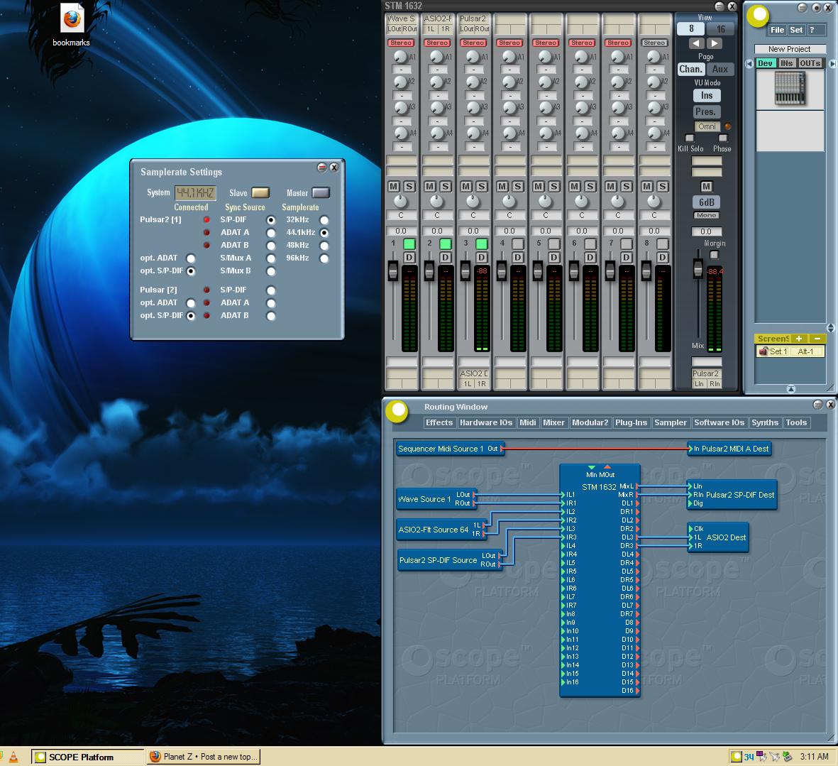

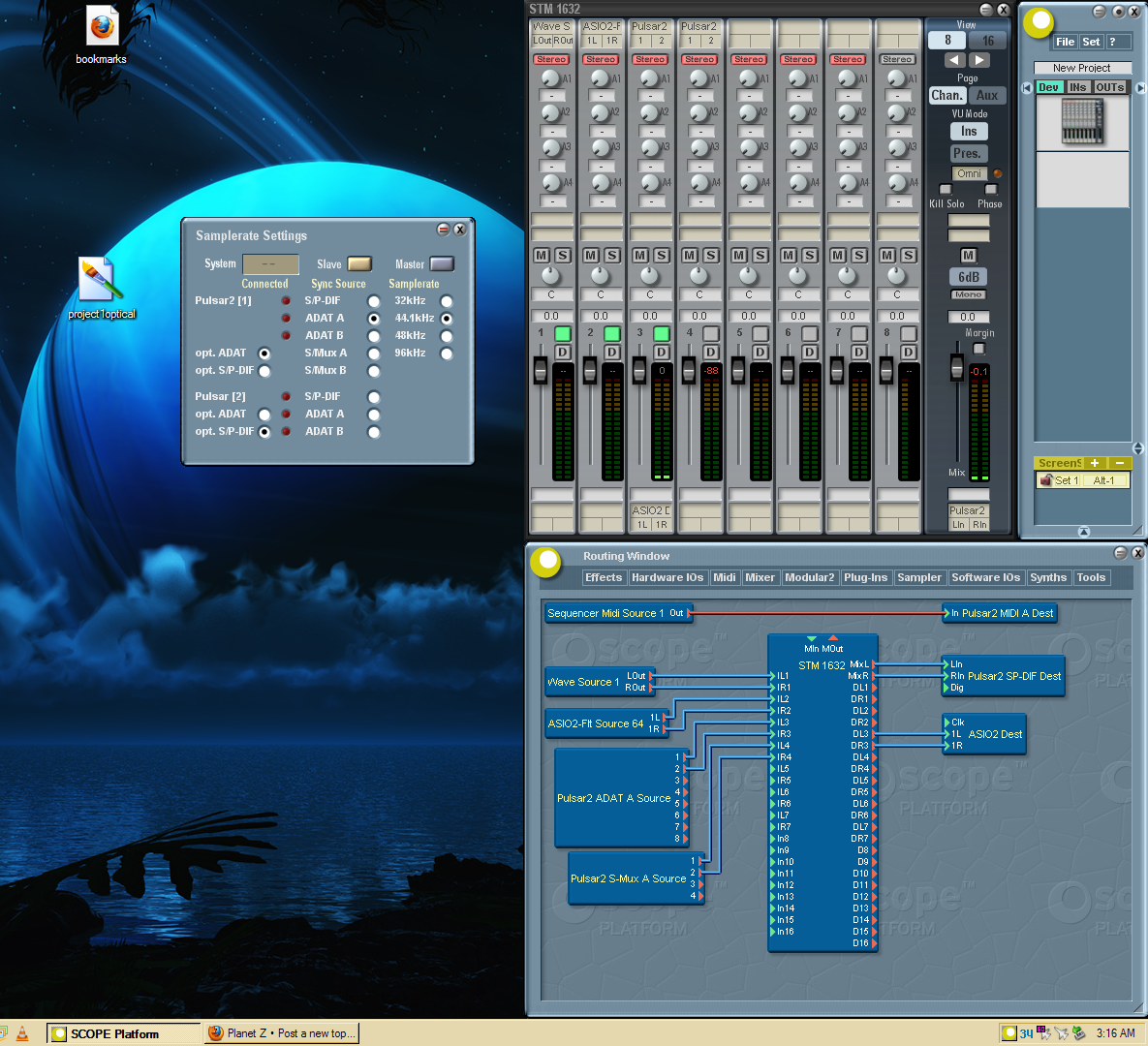

I am using Pulsar 2+1 and can't get the damn ADAT connections on Pulsar 2 to work in standard mode. And on top of that only ADAT A works along with SPDIF since they're both in OPT. SPDIF mode. In any other mode or configuration ADAT doesn't even show the little red light in samplerate window. So far I've tried loading all ADAT accessible modules and switching cables, but to no avail. So I guess the question is why doesn't standard mode work?
My system has scope 4.5 in pro mode, winxp home, and is very stable.
- standard mode.png (711.56 KiB) Viewed 2406 times
- spdif mode.png (703.42 KiB) Viewed 2406 times

I am feeding it from Lavry AD10, which is the master clock set to 44.1khz. And no I never included an ADAT Dest in the first image. Is this important?
