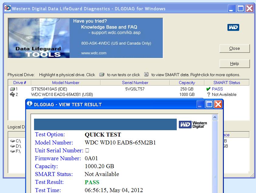

Its is indeed a WD Caviar Green, as I took it out of enclusre and used SATA Adapter Kit to power it up and connect to laptop, so I can hear the motor spinning and laptop recognises it, then I installed the diag and it says SMART Status is 'Not Available' :
wd_test
wd_test
The QUICK TEST passed, but the EXTENDED TEST will take 9 hours, so Ill run it over the weekend.
I dont give much hope though due to the 'Not Available' status, even if the test passes, cant see that it will bring it back online.

SATA Adapter Kit means a usb adapter of some kind? I would guess that's why you're not getting the SMART Status, the adapter probably isn't reporting it (able to poll the smart via whatever chipset it uses). Are you able to access the drive or see anything in Disk Management under Computer Management (in Administrative Tools)?

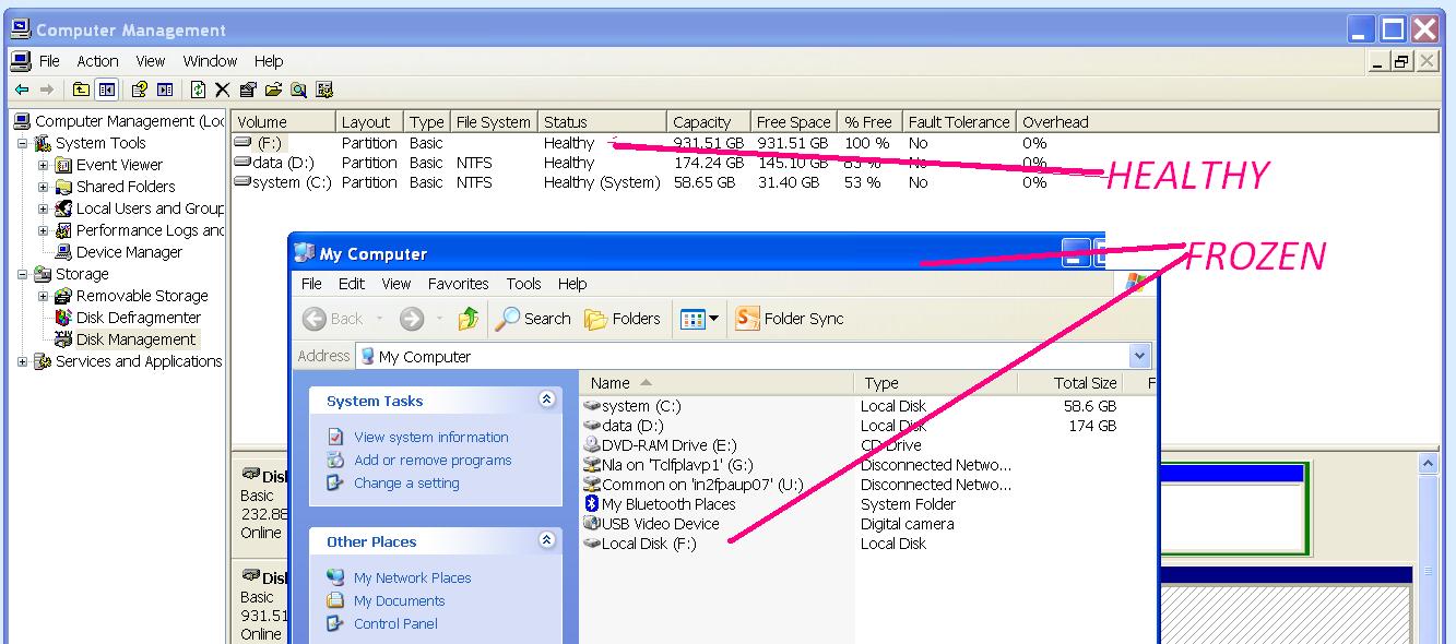

On the kit its says IDE / SATA / to USB 2.0 ADAPTOR.
Computer Management => Disk Management lists its status as 'Healthy' - but the 'My Computer' window with the F: drive listed in it is frozen.

Your file system type does not show as well...hmm.

Yeah, I did a 'quick format' and now I can access it. Must have been screwed up sectors :-?
Im not gonna use it again though as I dont trust it. Ill continue w/ the replacement Seagate.
Posts: 7745
Re: USB Hard Drive GOTCHA !! :(
Screwed up sectors is unlikely as that's lower level than the file system, it was probably just a screwed up file system/NTFS MFT (master file table) corruption. Honestly this is almost surely the result of the USB enclosure's failure again, what I would do is use the drive for nonessential data (movies that you will watch & delete, large downloads, temporary files etc) and just monitor its health over time. If it doesn't crap out in a few months it's probably fine.
